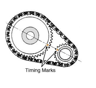

Just finished putting heads back on and forgot how to set timing. It has been a while since the last time I tore an engine down and put it back together.
I have number one piston up and intake valve is open.
Mar 25, 2008 at 9:57 AM
BMRFIXIT
  • 19,053 POSTS
this is the timing marks
https://images.2carpros.com/forum/automotive_pictures/99387_chevy_1.jpg

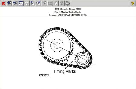

I have number one piston up and intake valve is open. Wrong -both valves should be close and rocker arms are rocking when no.1 is on the compression stroke-You are in the intake stroke of no.1 305/350 engines-
https://images.2carpros.com/forum/automotive_pictures/12900_timing_mark_2.jpg
Mar 25, 2008 at 11:48 AM
  • 75,988 POSTS

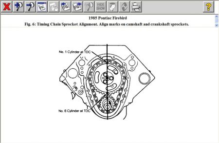

BMR this illustration looks crooked for a V8 chevy engine-don't you think so. I got a good one but couldn't find it we might have to comeback and correct this out it sure looks weird-We wait and see-
Mar 25, 2008 at 11:54 AM
  • 75,988 POSTS
See below
https://images.2carpros.com/forum/automotive_pictures/12900_good_one_1.jpg
