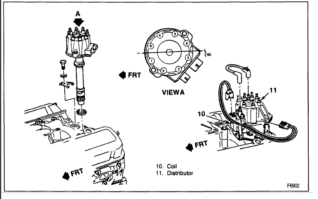

Where is the camshaft position sensor located I cant find it?

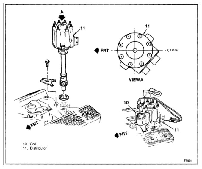

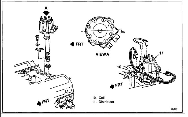

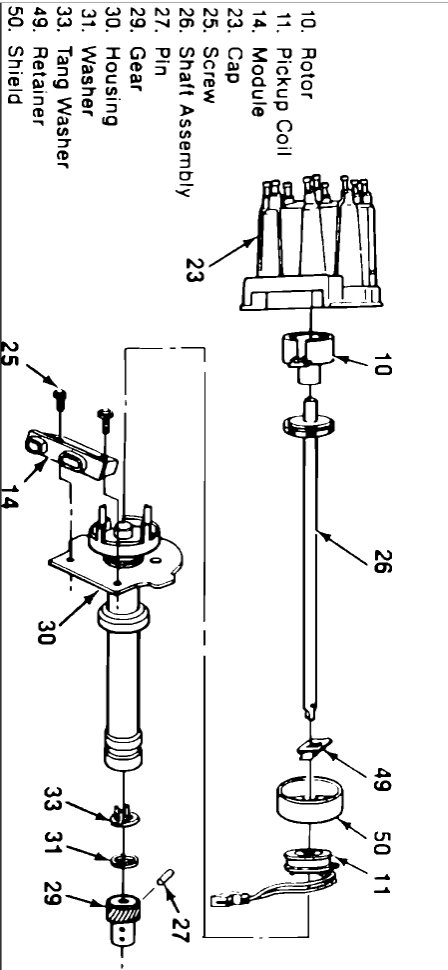

The sensor of the camshaft position is inside the distributor here is a diagram to help you see how to change it below.
Check out the diagrams (Below). Please let us know if you need anything else to get the problem fixed. Cheers

How to get sensor out of distributor
+3
Friday, February 26th, 2021 AT 5:59 PM (Merged)
BLUELIGHTNIN6
MECHANIC
16,542 POSTS
Just remove screw and remove the sensor from the distributor.
