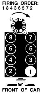

Well I tried to change the plugs and wires myself. The first side ( even #'s ) I just pulled all the wires off at one time. So I really didn't get the order down. The odd side I did one at a time so it should be correct. I tried moving them all around but no luck. It is still running rough ( off balance/out of order ) I guess. Any ideas on how to get the right order back in place? The ignition thing is numbered but I do not know which plug goes to which number.
Thanks.

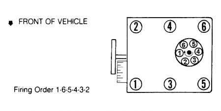

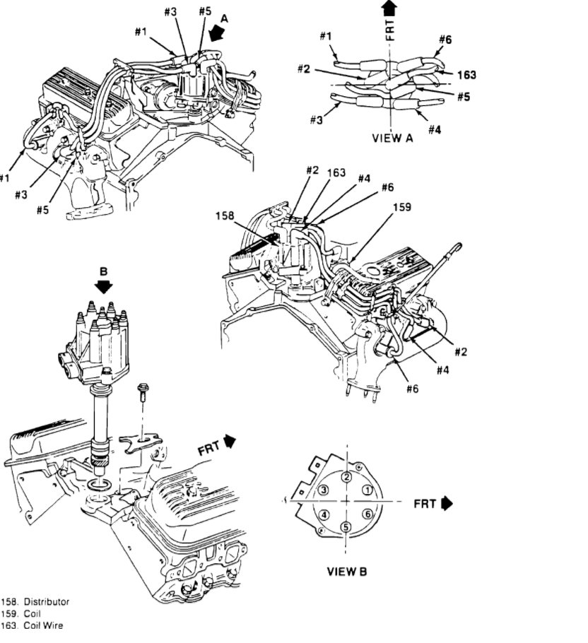

I have the 1500 model with the 4.3 Vortec V6. I recently did a tune up on the engine due to the mileage. I had my new brother-in-law help me out with the tune up. Well he pulled the wire off the plugs without marking the distributor cap and I am trying to find out how to set cylinder one so I can restart it. Please help! This truck is a business truck, and I am losing money just having it sit.

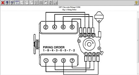

Here is the firing order for a 4.3 liter v6 and the 5.7 liter v8 chevy engine. Check out the diagrams (below) Firing Order 1-6-5-4-3-2 Firing Order 1-8-4-3-6-5-7-2
https://images.2carpros.com/forum/automotive_pictures/249084_Graphic_7.jpg

Putting the engine in now. will you please send me a firing order diagram? Thank you
Oct 20, 2020 at 6:01 AM (Merged)
JDL
  • 16,098 POSTS
Firing order 1,6,5,4,3,2.
The driver side bank, front to back, 1,3, 5.
The passenger bank from front to back, 2, 4, 6.

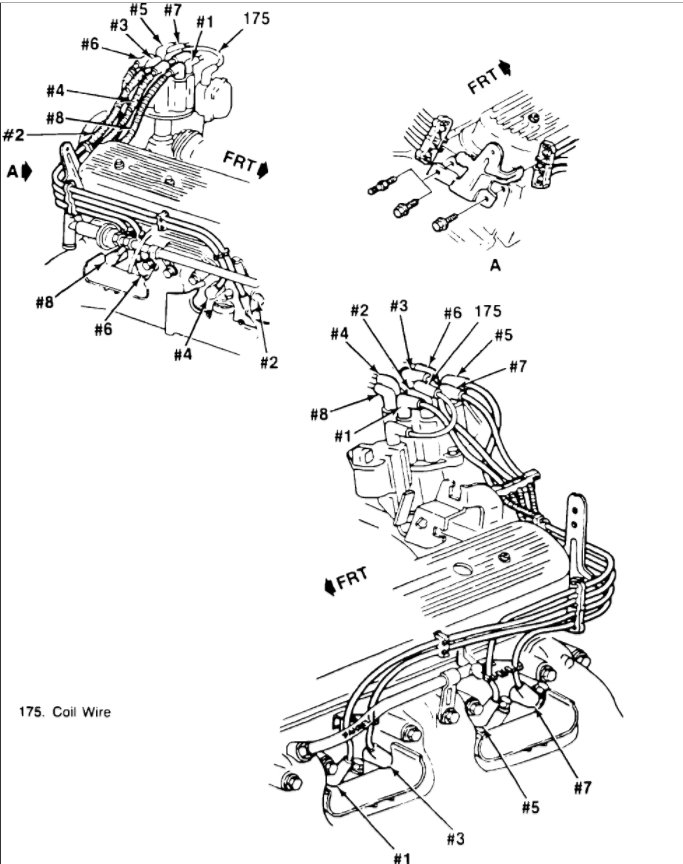

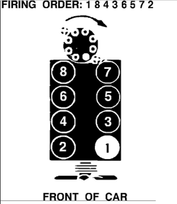

1991 Chevy Truck V8 Two Wheel Drive Automatic
What is firing order of 5.0 engine

https://images.2carpros.com/forum/automotive_pictures/188069_91Chevy5Lfireordr_1.jpg
