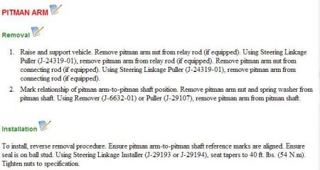

1997 Chevy Truck pitman arm replacement
WITNBOY
MEMBER
1997 CHEVROLET TRUCK
Steering problem
1997 Chevy Truck 6 cyl Four Wheel Drive Automatic
its hard to get at. I dont want to take out the steering box!
Wednesday, March 3rd, 2010 AT 8:02 PM
2 Replies
BLUELIGHTNIN6
MECHANIC
16,542 POSTS
If you dont have access enough to get the tools in there then may not have a choose but to remove it
