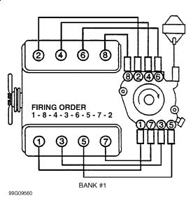

what is the fireing order on the distributor cap and ware is #1

Need engine size
Sep 15, 2009 at 2:19 PM
PAUL FINCHER
it's a 5.7 L
Sep 15, 2009 at 9:18 PM
DOCFIXIT
  • 18,828 POSTS
Hope this helps
https://images.2carpros.com/forum/automotive_pictures/198357_Graphic_134.jpg
