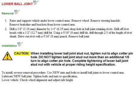

Living in Alaska and need help replacing my son's truck's upper and lower ball joints. Able to remove the upper, but can not break loose the lower. Need advise on how to change these out. Thanks.

See if this helps..
https://images.2carpros.com/forum/automotive_pictures/261618_Noname_821.jpg
