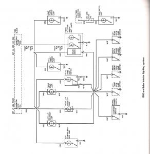

I HAVE A 1997 CHEVY CAVALIER, WELL THE DOME LITE WONT GO OFF, I HAD TO DISCONNECT THE BULB SO MY BATTERY WOULDNT DRAIN, AND THE HORN WONT BEEP,, THE HORN NOT BEEP HAPPENED 5 MONTHS AGO, NOW RECENTLY THE DOME LITE WONT KICK OFF? WONDERING WHAT THE PROBLEMS IS, ARE THE TWO CONNECTED???

check the door switches, if they ground out the light will stay on. the horn i would check the fuses if there are good use a test light and see if you have power to the horn.

there should be a screw by the switch holding the switch in place. unscrew it, slowely pull pull the switch out. there should be one wire going to it.
{ the light switch works as you open the door it make the switch ground on to the body when the door is opened } do one door at a time seeing if the switch is bad. note: when you take the screw out there might be a little spark, don't worry its just the swtch being grounded. if it is in one of the switches and you remove the screw it might be enough that the light will go off. check the wire on each switch. don't know how many doors you have but check each one seperatly. this will tell you if it is the door switch. let me know what you find!,

here is a diagram to help you.
https://images.2carpros.com/forum/automotive_pictures/54223_1992_up_interior_lighting_1.jpg

the dome lite staying on, has something to do with the door switches, cause the door was replaced recently, due to an accident. I close the door and lite still stays on. jessica

[quote:ecdb4df9f1="M_J_RITZEL"]the little black thing on the door that you can push in are the switches. there should be a screw that holds the switch in place.[/quote:ecdb4df9f1]
okay, there are no screws down there holding the door switches in place. The switches are just there, plastic, encased around a plastic black ring. but no screws to speak of. JESSICA
