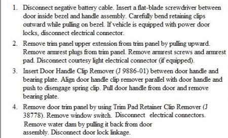

I need to replace the drivers side inside door handle.
How do I remove the door panel ?

BLUELIGHTNIN6
  • 16,542 POSTS
https://images.2carpros.com/forum/automotive_pictures/261618_Noname_2314.jpg
Jun 7, 2010 at 12:14 PM
