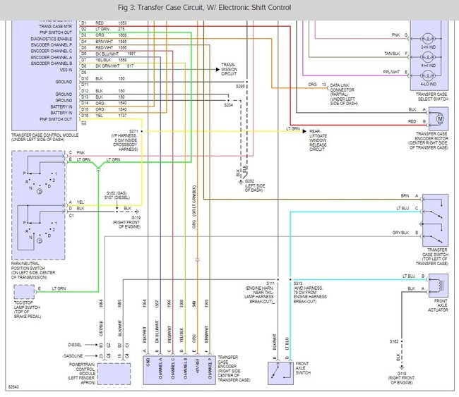

V8 Four Wheel Drive Automatic 180000 miles. I put it in 4wd last week while I was on a wet slick dirt road at the hunting club. When I got on the paved road I took it out of 4wd. A a few mins. later I tried to put it back in 4wd and it would not engage. I have 3 buttons on the dash one is 2wd one is 4wdh and one is 4wdl. The light on the 4 high and 4 low would just flash. I can hear the transfer case shifting into 4wd but the front dif is not activating. To make it short the light on the buttons will flash but the front end will not lock in to 4wd. Nothing I that I do will make the 4wd lock-in. I disconnected the plugs from the Actuator Switch one of them had a little water in it but it looked like new inside. I checked the voltage on the plugs with my fluke meter. I was getting around 6 volts on one and around 8volts on the other one. I am guessing the actuator is a normally closed contact because with the I activated the 4wd there was no reading(voltage). I also checked the fuse and it was good.
What is keeping my 4wd from activating?

When you are in 2wd sitting at a stop, in park or neutral, and you press four high, do you hear anything, and does the light continuously flash or revert back to 2wd. How about four lo, you should definitely hear and feel that shift, as well as the gear reduction, does it continue to flash, or revert back to 2wd.

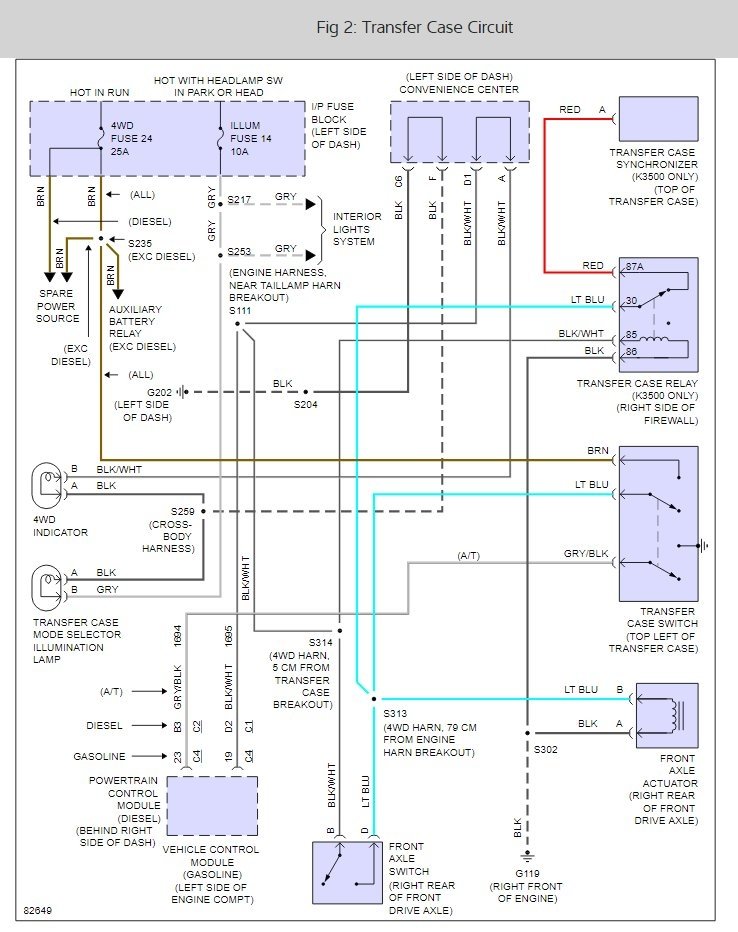

Which wires(what colors) at what switch did you check? At the actuator I am showing a two wire connector, a light blue wire and a black wire. The black wire is shown as hard wired to ground(g105). There is also a front axle switch that has a two wire connector, the same lght blue circuit as the actuator, and a black white hat looks like, in theory, should be grounded by the transfer case control module. There is a bulletin, and a revised schematic, if the new style front axle actuator has been installed.
Ok, I put the truck in the garage where I could get some light on the situation. I un-plugged the connectors at the actuator I am getting around 13vdc when I press the 4wdh or 4wdl buttons. I might be wrong but it sounds like the actuator is not activating. A couple of questions. If it is the actuator and I take it out will the gear oil drain out when it is removed if so where and how much oil do I replace it with. Also what is the other two wires for that go to the transfer above the actuator.

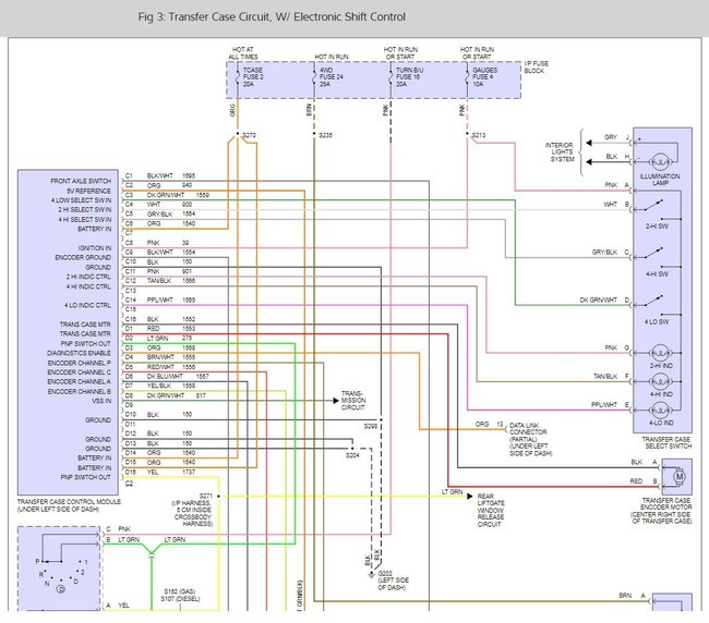

Here are some wiring diagrams (below) and guide on how to test for power, it sounds like a switch has gone out.

When I press the 4wdh or 4wdL I can hear and feel the transfer shift. The light on the 4H or the 4L will flash on the button that is pressed. It does not revert back to 2wd until the 2wd botton is pressed I let it flash for about 10min the night it started doing this. I can hear the switchs or relays in the dash when the 4wd bottons are pressed but I havn't went into the dash and checked them. The wires that I was talking about are the wire that go to the actuator under the front end (not sure what the proper name for it is but it is where the actuator for the 4wd is located or the gear box that locks the front two cv's in to make it 4wd.) one set of wires went directly to the actuator switch and one set go above it on top of this front transfer case(gear box).
Sorry I can't discribe it better. I am a electrical eng. and I don't know certain terms of car parts. It seems to me that everything is working but the final part that makes the 4wd lock-in. So what do you think. If this doesn't help then I will get my brother to discribe it better tomorrow he knows what all of name of these parts are.

Was that 13v using the ground at the connector for the actuator? If you remove the actuator, you should not have much oil leak out, maybe even less to none if you lift the RH front side of the vehicle a bit. If you do have some loss, the fill plug is on the LH side of the differential, above the drain plug toward the front. The fill plug is 15mm, the drain is 13mm. Fill it through the fill hole until fluid runs out.
The wire colors at the actuator should be light blue, and black, is that correct? What are the wire colors that go o the other item that you are speaking of. My guess is, it is a switch that will confirm that the actuator is locked in, this may be what will stop your lights from flashing. The problem with the service information that I am referencing, is it gives no component location description or views. I am going off of the wiring schematic from ALLDATA.

Yes, I plugged the leads of my fluke meter in to the connector for the actuator and this is where I got the 13v from. I am getting power to the actuator but it is not engaging. The wires both look black or dark blue to me I could not tell, But there is not a light blue wire. If the actuator is not working then it is not going to activate the switch at the actuator to sent a signal back to the switch in the dash to let it know that the 4wd has been actatived. I am thinking that the switch above the actuator is working like a limit or some call it a lever switch. Once the actuator is engaged it actavates the switch above the it and it will send a signal back to the dash switch to let it know the the 4wd is actavited.

That switch actually sends the message to the transfer case control module. A quick test would be to jumper the terminals of that switch together. If this stops the lights from flashing, and you are getting the signal to the actuator, then I would suggest a bad actuator. You might be able to bench test the actuator by applying power and ground to it. The symbol in the actuator shows that it is a coil of wire, or a resistor of some sort. You could also check the continuity of the actuator. If it is open, then it is safe to say it's faulty. Service information does not specify an electrical specification for the actuator. It should have some resistance, probably like a fuel injector or similar, possibly 10 to 20 ohms I would guess. Substantially low resistance could indicate shorted windings, excessively high could indicate high resistance or open circuit. I believe the case of the actuator is plastic, so if it was shorted to the case it would not find a path to ground. The following bulletin may interest you if you need to replace the actuator. I am not certain if this upgraded part and procedure address just the complaint as stated, or if it is necessary in the case of any actuator replacement.

Ok i'm back. I changed the actuator tonight the 4wd works know. But the lights are still flashing on the 4wdh and 4wdl buttons. I also tested the old actuator. It was dead I could not get it to do anything. What do you think is going on with the flashing switchs. I even disconnected the battery to see if this might reset something. Do you think that it could also be the other switch on the hoghead. I will try to jump the switch's wire togeather tomorrow night and see if the lights quits flashing. If you go to O'ReillyAutoParts.com and type in the part # FWD18. This is the switch you are talking about. BWD - Four Wheel Drive Indicator Lamp Switch

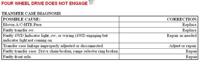

Attached is a chart for possible causes of 4WD not engaging.
What is the transfer case model identification?
