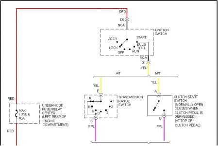

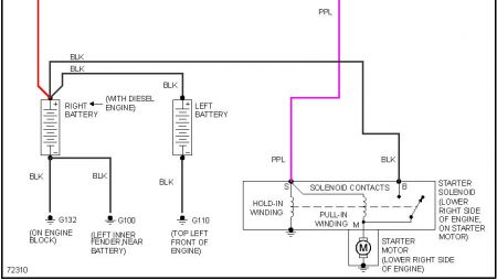

i just put a new motor in my 95 chevy truck an i cant rember how to wire the starter up
Mar 3, 2010 at 12:33 PM
BLUELIGHTNIN6
  • 16,542 POSTS
The small wire goes to the termaily closest to the engine block and the others all go to the large power lug on the solenoid. This guide can help and i have included the starter wiring diagrams below https://www.2carpros.com/articles/how-to-replace-a-starter-motor
