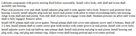

What are the specs on adjusting the stub shaft after seal replacement for the gearbox
