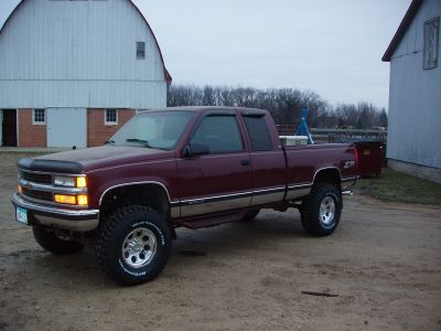

My truck has some performance products added to it such as: AME cold air intake system, Accel ignition tune-up kit, Hyper-Tech computer chip, street performance throttle body spacer, dual exhaust, and Jet Performance thermosate. Do you recommend using engine flush when changing a trucks oil? [img:a92c97d1b0]http://www.2carpros.com/forum/automotive_pictures/218590_P1010012_1.jpg[/img:a92c97d1b0]Also I put maybe 3000 miles a year on this truck at most, what is the best way to store a vehical to keep it running at its peak performance? Thanks
