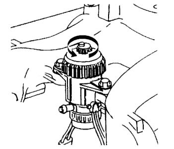

can you please tell me where the fuel filter is located on a 1995 chevy 3/4 ton desiel truck and where the fuel pump is located.Thanks

The fuel filter is a replaceable cartridge mounted on the engine. The fuel filter is attached to the front of the intake manifold between the first two runners.
https://images.2carpros.com/forum/automotive_pictures/561653_Fuel_filter_95_2500_DSL_1.jpg
The fuel lift pump is mounted to the inside of the left frame rail.
