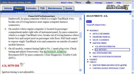

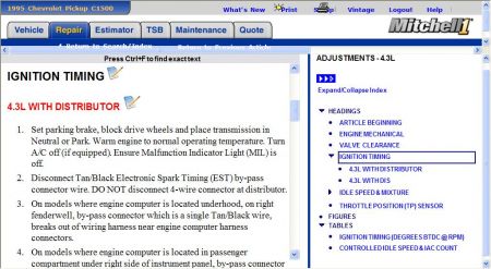

1995 Chevy Truck 6 cyl Four Wheel Drive Automatic
How do you set the timing
Jan 8, 2009 at 1:52 AM
  • 75,992 POSTS
See below
https://images.2carpros.com/forum/automotive_pictures/12900_timing1_1.jpg
https://images.2carpros.com/forum/automotive_pictures/12900_timing2_3.jpg
