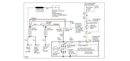

While driven my alternator needle jumps from 11 to 14. I have changed the alternator and battey. After about 3 weeks it started to act up again. Before I changed it the 2nd time I had the alternator tested and it checked good but the folks at autozone replaced it anyway. Every thing worked good until today and it has started again. Lost were do I go next. (tomandlesliejones3@gmail.com)

Get the alternator load tested again and double check all connections. See your Charge system EWD below
https://images.2carpros.com/forum/automotive_pictures/12900_alty_41.jpg
