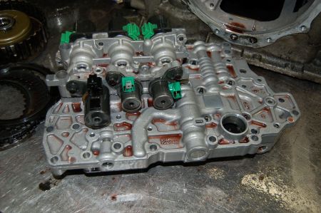

Feb 25, 2007 at 11:34 AM
CHEVY22
  • 1,375 POSTS
very simple , the pan comes down , and the valve body is right there , abot 15 bolts it comes down and there are all of the valves and solenoids , there are amll mods along with replacing the solenoid that can be done to make it shift better and the pulse width modulator is changed to work or not work instead of coming half off or on , check around on pricing you may have better luck with a small shop that does transmission only and has been around for a while thansk jim oh and leave some feedback if you were happy with your help , we all donate our time here helping others free of charge this is a valve body not your type but it will give you an idea on what they look like
