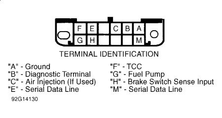

Sometimes when the truck is shifted into overdrive the transmission won't shift out of drive into overdrive instead the RPMs climb to redline. Other times it will shift back and forth between drive and overdrive very quickly. Also when it shifts between any gear it sometimes shifts hard with a load thud and you can really feel it. This all started all of a sudden a week ago.
The truck is a 1991 Chevy 1/2 ton extended cab truck 4x4 with a 5.7L V8 EFI engine. I do not know what the automatic transmission is or were to look but I am pretty sure it's the factory original.
Any help would be greatly appreciated.
Thanks
Shane
Sep 27, 2009 at 5:02 AM
DOCFIXIT
  • 18,828 POSTS
Hi Maybe faulty shift solenoid or TCC. Find ALDL underdash see figure
https://images.2carpros.com/forum/automotive_pictures/198357_Graphic_150.jpg
Jumper between term. A&B paper clip will do turn key on DO NOT start. MIL will flash like flash, flash, pause flash that's 21. see what codes are present and post. Thanks for donate

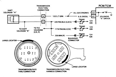

The only code I got was 12 and 82.
Sep 28, 2009 at 12:58 PM
DOCFIXIT
  • 18,828 POSTS

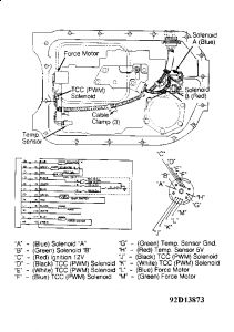

12 means no engine code 82 means shift solenoid "A" faulty. Need to drop pan to get at solenoid on valve body
https://images.2carpros.com/forum/automotive_pictures/198357_Grafic_3_43.jpg
. ground terminal "B" at ALDL solenoid should click if no replace.
https://images.2carpros.com/forum/automotive_pictures/198357_Graphic_158.jpg
Sep 29, 2009 at 2:24 AM
SFLYBOY
  • 5 POSTS
I replaced the shift solenoid "A" and the trany shifts better then it has in a long time.
