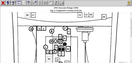

Its on location C2 Under left side of dash, to left of column. this guide can help
https://www.2carpros.com/articles/buick-cadillac-chevy-gmc-oldsmobile-pontiac-gm-1983-1995-obd1-code-definitions-and-retrieval-method
https://www.2carpros.com/forum/automotive_pictures/12900_dlc_24.jpg
