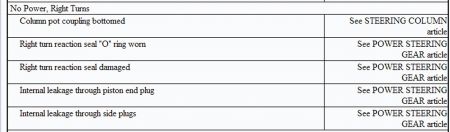

Steering problem
1990 Chevy Truck 6 cyl Two Wheel Drive
REPLACED SEALS IN STEERING BOX , HAVE DONE SO MANY TIMES , NEVER A PROBLEM , CHECKED EVERYTHING , RECIRCCLATING BALLS ALL IN PLACE , CORRECT NUMBER AND ORDER , NOTING CHIPPED , BROKEN OR MISSING , JACKED UP FRONT END AND BLED PUMP SEVERAL TIMES , HAS POWER STEERING TO LEFT , NO POWER STEERING TO RIGHT , WHAT DID I DO WRONG , THANK YOU

https://images.2carpros.com/forum/automotive_pictures/62217_SteeringTS_1.jpg
