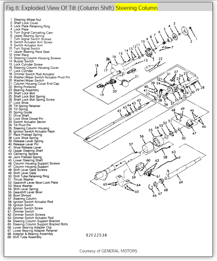

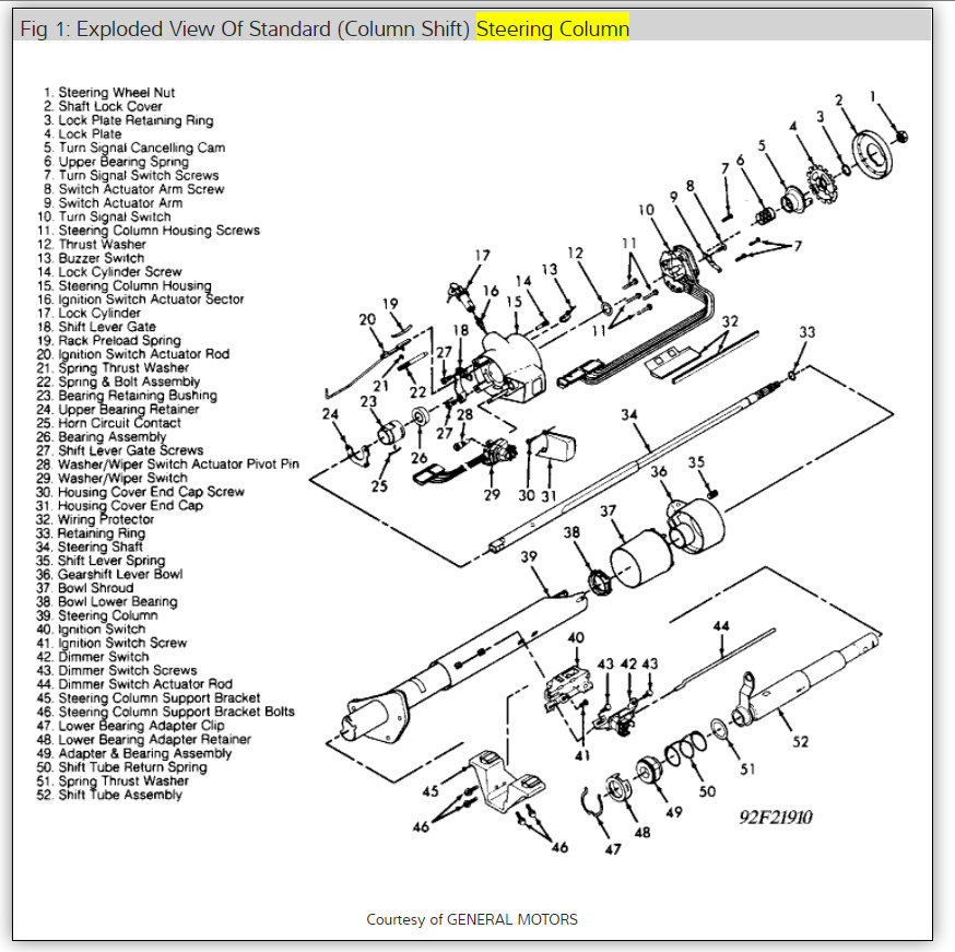

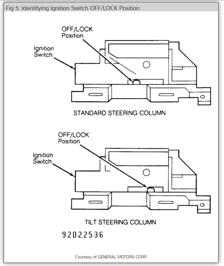

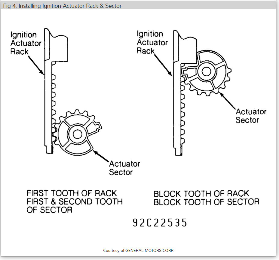

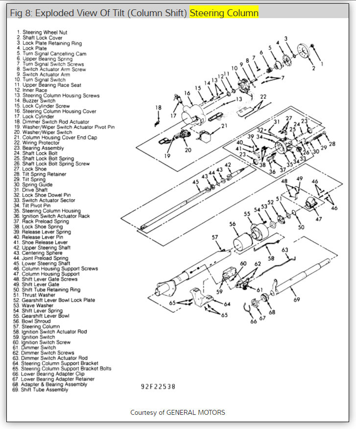

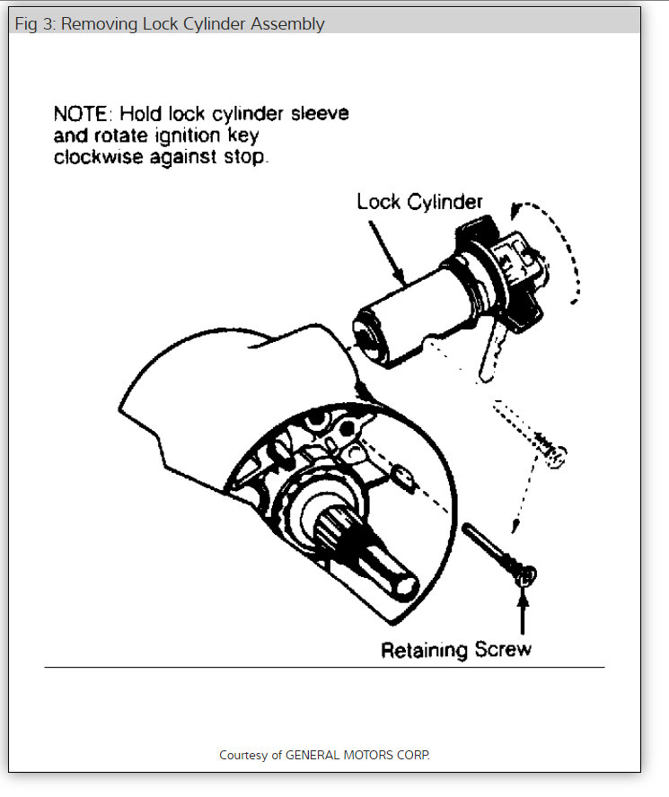

I am trying to change out my ignition switch(key &tumblers) how do I get it out?
Sunday, May 24th, 2009 AT 2:00 PM
13 Replies
JDL
  • 16,098 POSTS

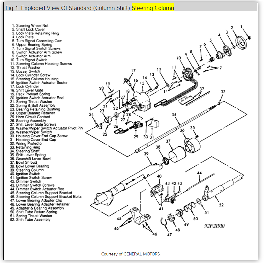

Here are the instructions in the diagrams below to show you how on your car. Check out the diagrams (Below). Please let us know if you need anything else to get the problem fixed.

Ignition lock cylinder needs removed. To do so, perform following operations.
Remove the steering wheel.
Remove the turn signal switch. It is not necessary to completely remove the switch from the column. Pull the switch rearward far enough to slip it over the end of the shaft, but do not pull the harness out of the column.
Turn the lock to Run.
If necessary, remove the ignition key.
If equipped, remove the buzzer switch assembly.
Remove the lock retaining screw and remove the lock cylinder.
Rotate the key to the stop while holding onto the cylinder.
Push the lock all the way in.
Install the screw. Tighten the screw to 40 inch lbs. (5 Nm) for regular columns, 22 inch lbs. (2.5 Nm) for tilt columns.
Install the turn signal switch and the steering wheel.

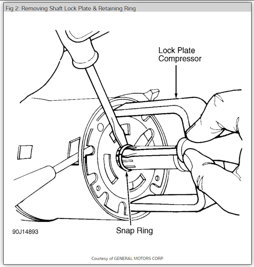

He is correct but he is talking about the ignition switch, you are talking about the ignition lock cylinder. You will have to disassemble part of the steering column. If you don't have a gm lock plate remover you will want to rent 1. If you need instructions on how to do it let me know and I will walk you through it.

Sorry about that, I edited above post to removing lock clyinder, not switch. Thanks Bowtie Baby.

No problem, I worked in parts for a long time and many people mistake the two of them. Good luck, let me know if you need more info. The car pro guy is correct but he left out the lock plate removal, you have to compress the plate and spring then remove the retaining clip.

REMOVAL:
Remove steering wheel and turn signal switch.
It is not necessary to completely remove the turn signal switch. Pull the switch over the end of the shaft; no further.
Place lock cylinder in RUN position.
Do not remove the ignition key buzzer.
Insert a small drift pin into the turn signal housing slot. Keeping the drift pin to the right side of the slot, break the housing flash loose and depress the spring latch at the lower end of the lock cylinder. Remove the lock cylinder.
WARNING
Considerable force may be necessary to break this casting flash, but be careful not to damage any other parts. When ordering a new lock cylinder, specify a cylinder assembly. This will save assembling the cylinder, washer, sleeve and adapter.
INSTALLATION:
Hold the lock cylinder sleeve and rotate the knob clockwise against the stop.
Insert the cylinder into the housing, aligning the key and keyway.
Hold a 0.070 in. Drill between the lock bezel and housing. Rotate the cylinder counterclockwise, maintaining a light pressure until the drive section of the cylinder mates with the sector.
Push in until the snapring pops into the grooves. Remove drill. Check cylinder operation.
The drill prevents forcing the lock cylinder inward beyond its normal position. The buzzer switch and spring latch can hold the lock cylinder in too far. Complete disassembly of the upper bearing housing is necessary to release an improperly installed lock cylinder.
