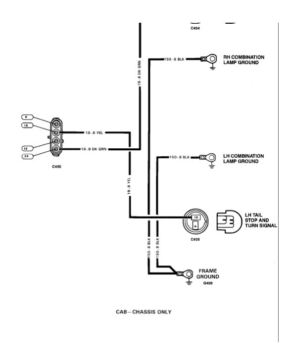

My turn signals quit.I changed the fuse,flasher fuse,turn signal switch,head lamp switch.flashers all work but no t/s.only half of instrument cluster is lit up now

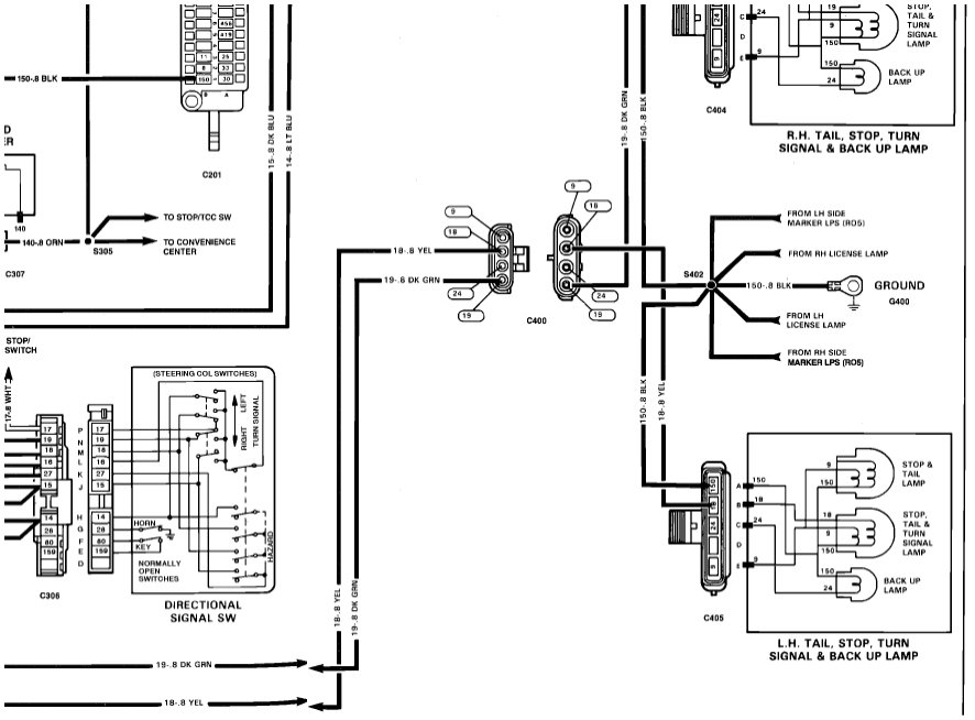

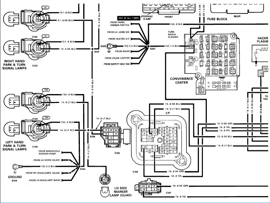

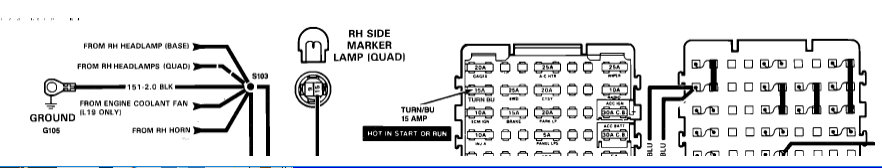

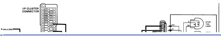

Welcome, just talking about turn signals. Did you check circuits at turn signal switch while you were replacing switch? Sure would have been a good time. Here is a guide and some diagrams so you can do some testing https://www.2carpros.com/articles/how-to-use-a-test-light-circuit-tester There is probably a multiwire connector under the dash close to steering column, for circuits going to and from the column. You can see wiring colors in diagram. Use testlite on proper wiring circuit, see if it is hot when it should be?
https://images.2carpros.com/forum/automotive_pictures/170934_89_turn_switch_diagram_1.jpg
Larger diagram below, sorry they are in pieces. Please let us know what happens so it will help others. Cheers
