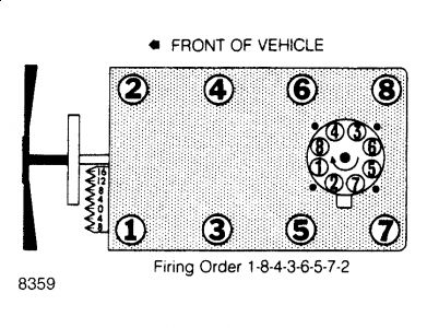

1989 Chevy Truck distributor placement
UNSTABLEABLE
MEMBER
1989 CHEVROLET TRUCK
V8
2WD
AUTOMATIC
44,589 MILES
I need to know the distributor timing in the firing order for 454 chevy with fuel injection
Sunday, May 10th, 2009 AT 5:17 AM
BMRFIXIT
MECHANIC
19,053 POSTS
Check this one
this is for K engine and If I recall they are the same
good luck
need manual CHECK IT @
https://www.2carpros.com/kpages/auto_repair_manuals.htm
