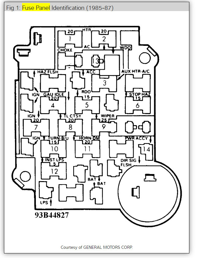

Where is the fuse box located for a 1987 chevy truck?
May 20, 2008 at 12:40 PM
MHPAUTOS
  • 31,937 POSTS

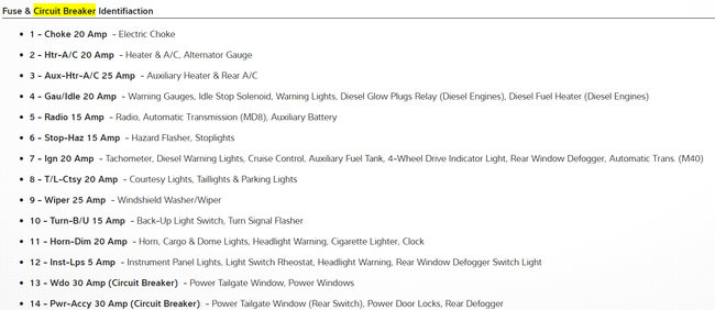

Here is a guide to help you check the fuse and the fuse box location and fuse identification as well.
Fuse Block Under left side of dashboard. Check out the diagrams (Below). Please let us know if you need anything else to get the problem fixed.

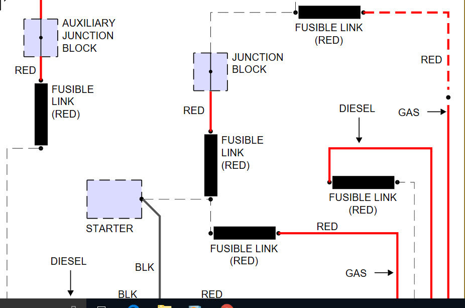

I hooked the battery up backwords and I cannot find the
the fusible link or could it be something else?
Oct 20, 2018 at 11:22 AM (Merged)
HMAC300
  • 48,601 POSTS
the fusible links run off the starter.also if you have a junction box near battery on firewall or fender-well. see picture.
