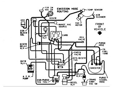

2 Questions My 86 Custom Deluxe has a Carb and I need a diagram of the vacuum hoses for the 305 eng. I want to make sure I redo them right. Also I took the passenger side value cover off because of a pretty hard tap that would be heard at idle some of the time. I thought I had a bent push rod. But the noise stopped for now and all the rods spin freely at idle and even when I idle it up some. Could it be the fuel pump or maybe a rod that is a little bent. It's a noticeable tapping when it does it. But now that the cover is off it's not doing it.

Ok, on the Vacuum Diagram need to know if canister is on driver or passenger side.

The canister is on the driver's side.

I say check the inside of valve cover for damage because after you took it off the tapping was gone. Inside the valve cover on some models there is a plate that prevents oil from spraying out the oil fill and the PCV Valve. If the plate has been damaged or has broken loose could be cause of tapping. Here is the Vaccum Diagram...
https://images.2carpros.com/forum/automotive_pictures/188069_86chevy305vacuum_1.jpg
