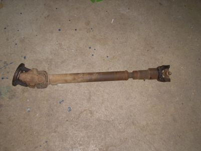

i have an 86 chevy k20 pickup rebuilt with new transmission, different engine and headlight clip, wheels, brakes, suspension, and rear drive train. im now working on the u-joints on the front driveshaft and was wondering if someone could explain to me if the u-joint connecting to the front axil pumpkin is the only one i can replace[img:6bd1a9f3e7]http://www.2carpros.com/forum/automotive_pictures/144510_P1170115_1.jpg[/img:6bd1a9f3e7]

no. you can replace the other 2. ** there is a small needle bearing inside the part that pivots, you can replace that too. most of them that bearing is wasted and noone changes them. just pack it with grease. it takes a little more patience to replace the other 2 but its not hard. feedback and votes are greatly appreciated.
