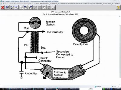

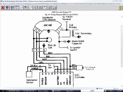

1986 Chevy Truck
1986 CHEVROLET TRUCK
167,000 MILES • 6 CYL • 2WD • AUTOMATIC
SCOTTENGLAND
no fire replaced coil cap rotory button plugs wires
Apr 6, 2008 at 3:03 AM
MERLIN2021
  • 17,250 POSTS
Try taking the HEI out of the distrubutor and getting it tested, either that or the ESC module...aslo if your TACH wire is unplugged, or grounded, you will get no spark...
