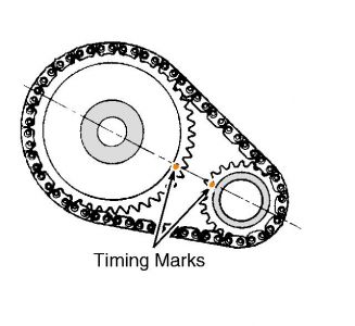

when you replace the timing chain .. you line the two dots on the timing gears up .. does this mean you have top dead center also or are you 180 out at this time at the distributer.. i rebuilt the motor thats why im asking..

https://images.2carpros.com/forum/automotive_pictures/99387_chevy_2.jpg
If you set the timing like this then your dist should be dead on if you set the cam pointing up then your dist is 180 off
