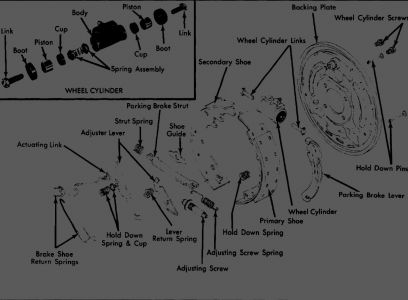

We need any diagrams or installation walkthroughs

Does this look right? Do one side at a time. Use a digital camera before hand if needed. Machine or replace the drum. Half a million miles...nice!!!
