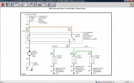

I need to know how to install a complete horn button kit. I have the kit but no instructions. Do you have a picture with the exploded view?

Use the factory wires and all you need to do is hook up the wires and mount the button. can'go back to 69' but horn circuits are pretty much as they have always been. This is an 80's G20
https://images.2carpros.com/forum/automotive_pictures/62217_horn_1.jpg
