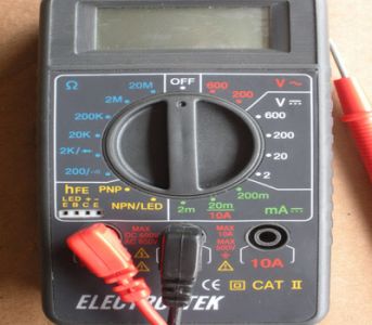

I have another question, it's about the charging system.
Is there a way to test the charging system, or to see if there is a constant drain being put on the battery from somewhere?
Now I just went out and bought a die-hard battery for the truck. When I started the truck everyday for a couple months, the battery seems to stay charged. It would start great...
But I let it go for almost 4 days without starting and now the voltage for the battery is at 10V. & the truck will not start.
Could there be a constant drain on the battery somewhere with the truck? How would I begin something like that?
Help?
Thanks,
Toki Tover
Jan 31, 2010 at 9:47 AM
OBXAUTOMEDIC
  • 3,711 POSTS
Hey Toki,
Yes and Yes...
Check link below for Checking Alternator. But you will need a DVOM (Digital Volt Ohm Meter).
https://www.2carpros.com/how_to/how_to_test_alternator.htm
To test for a draw you will need either a DVOM or Test Light.
First make sure everything is off and if there is an under hood light remove it.
Then remove the Negative Cable from Battery. Connect either the test light or the DVOM between the Battery Terminal and the cable.
If using DVOM if it shows more than 000 then you have a draw.
If using a test light then if the Light comes on you have a draw.
In order to find the circuit the draw is on just start pulling fuses one at a time checking the light or DVOM after each fuse.
Once light goes out or DVOM shows 000 then you have found the cicuit the draw is on.
Once found post the fuse # and if you have the user manual look up the items the circuit covers.
We will determine posibly causes.

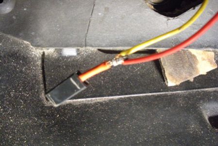

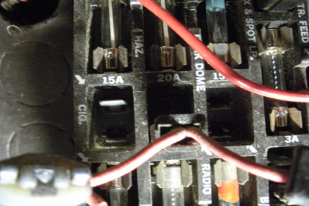

Hey obxautomedic, Ok, I had a test light and pulled the fuses one by one until the light went out. The one that I pulled out, which made the light go out, was labeled "CIG." I attached the picture of the plug and the fuse box for you to see.
https://images.2carpros.com/forum/automotive_pictures/454785_DSCN18341_1.jpg
This picture below was the plug for that fuse.
https://images.2carpros.com/forum/automotive_pictures/454785_DSCN18381_1.jpg
What are my next steps to figure out why it is creating a draw? Thanks! Toki

Ok, That is you Cigarett Lighter.
Does it work?
Do you have anything plugged into it?
In the Pic of the wires I see what looks like someone tied into the circuit. Can you see were the Yellow Wire goes to?
Mar 21, 2010 at 4:42 AM
TOKI TOVER
  • 25 POSTS
No, the cigarette lighter does not work. I looked and there was nothing connected the the back of the lighter assembly itself. I also noticed the radio did not work after I pulled the plug out. So that yellow wire seems to be the power wire for the radio. Where should I wire the radio power to? I also got a meter, picture below, but if I wanted to check for a draw, how could I set the meter up to check the battery?
https://images.2carpros.com/forum/automotive_pictures/454785_DSCN18401_1.jpg
I wanted to know because I left the truck overnight with the battery hooked up and that CIG. plug pulled, yet the voltage in the morning was 12.1V The voltage of the battery with the truck running was at ~14.2V - Do you think that it could be the alternator doing this? Thanks! Toki

Ok, have you pulled the radio to look at the wiring harness on the back? Also does the radio have a digital clock. The Main power wire for the radio should be wired into a fuse the is only powered when key is turned on. If it has a digital clock there will be I beleive a pink wire that should be wired to a continuous power source. The draw is so small it does not drain the battery and will not show up on the test light draw test.
Mar 22, 2010 at 2:33 PM
TOKI TOVER
  • 25 POSTS
I figured it all out with what was happening with the battery draw.
There were two wires connected, one to power the radio and one that powered the tachometer. I have since then changed that all and just got a die hard battery!
