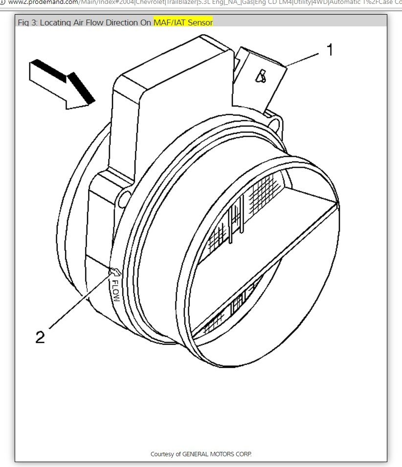

Is the IAT Sensor integrated into the MAF plug? I want to install a SLR Performance Chip in my 08 Trailblazer w/6.0 V8 and I need to attach their chip to the IAT Sensor. I'm not sure where the IAT sensor is or the location of the MAF plug. Can you point me in the right direction to help me locate/indentify these two items.

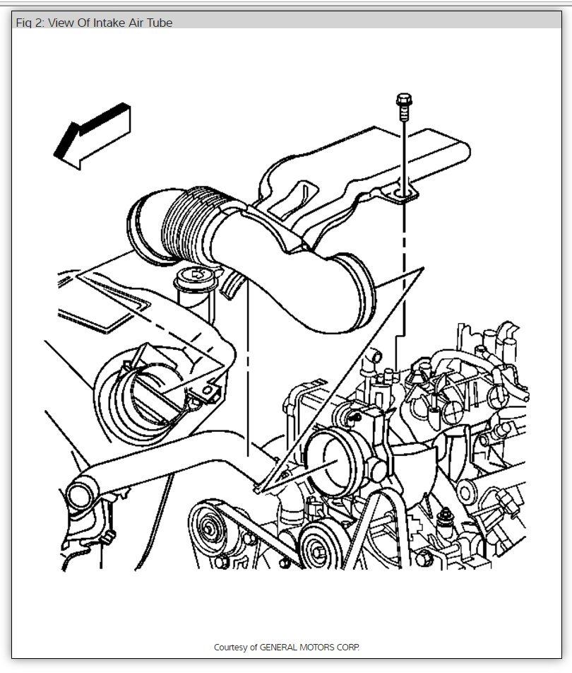

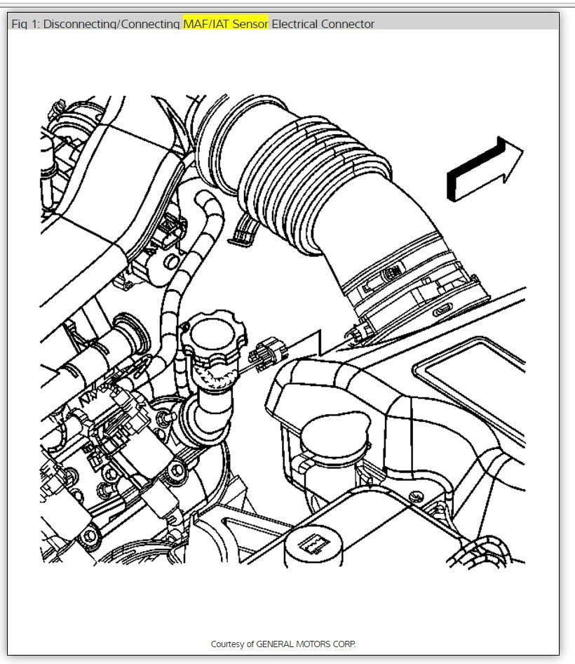

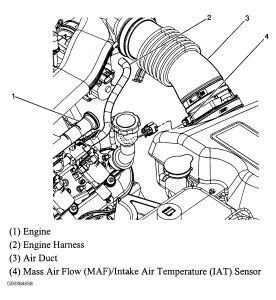

Where is the mass airflow sensor on a 2004 chevy trailblazer 4x4 ls ext 4.2 engine?
Sep 23, 2019 at 6:11 AM (Merged)
  • 55,399 POSTS
Check out the diagrams (Below). The mass air flow sensor is located at the air filter box where the intake tube connects. Here is a guide that will help you step be step on a similar car with diagrams (Below) to show you the location of the MAF for your car.
