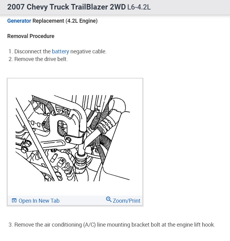

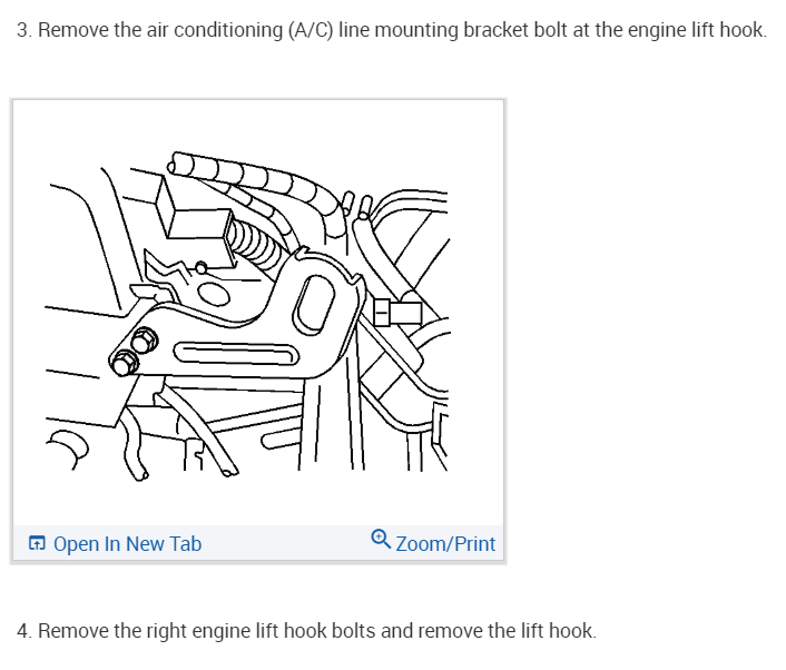

bearing going out on alternator, how to remove and install replacement
Dec 11, 2009 at 7:32 AM
BRIAN 1
  • 1,030 POSTS
Hello
Here is a guide to help walk you through the steps with instructions in the diagrams below to show you how on your car.
https://www.2carpros.com/articles/how-to-replace-an-alternator

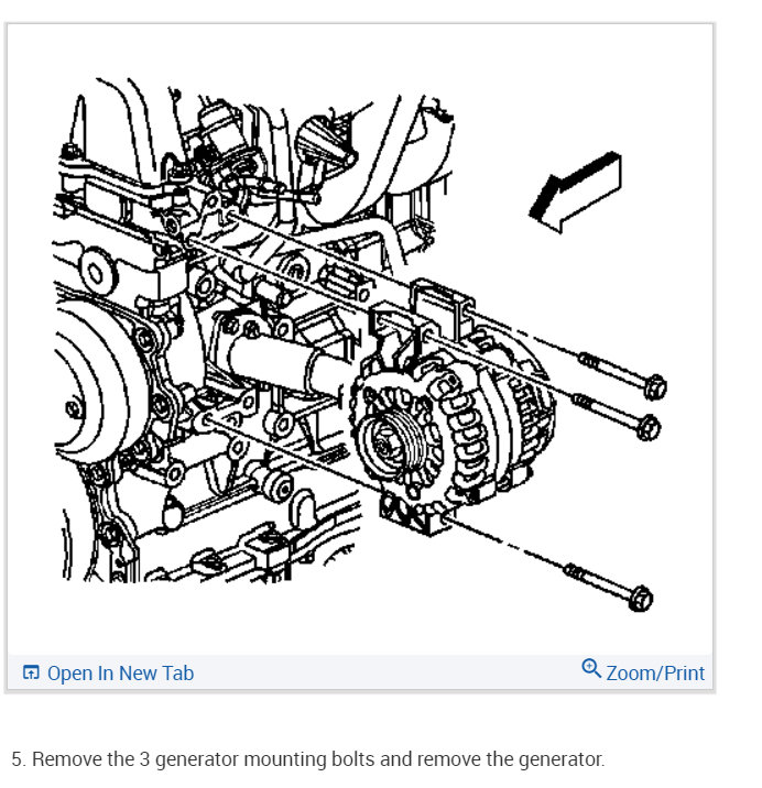

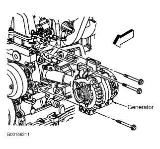

BK_IOOF
diagrams for changing out a alternator bolt locations
Nov 23, 2019 at 6:25 PM (Merged)
MMPRINCE4000
  • 8,548 POSTS
https://images.2carpros.com/forum/automotive_pictures/108325_alttrailblazer_1.jpg

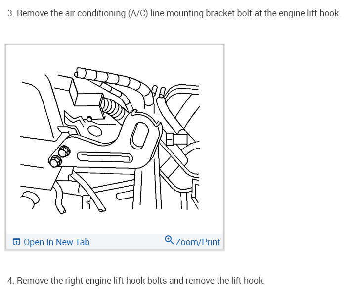

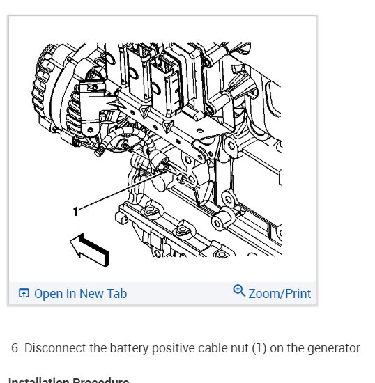

GREG KING
how to replace
  • 110,194 POSTS
Greg:
This is a straight forward repair. First, disconnect the battery. Rmove the serp belt and wiring from the alternator. After that, remove the mounting bolts that hold the alt to the mounting brackets and the alt will come off. Reverse the order to replace it.
If you run into trouble, let me know.
