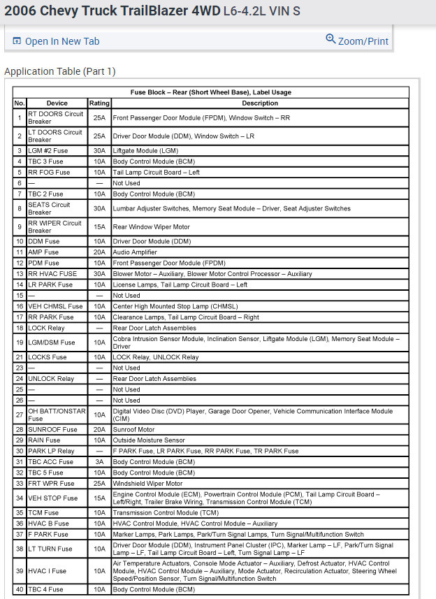

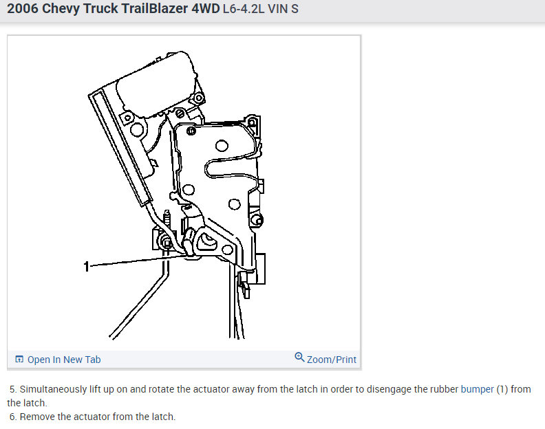

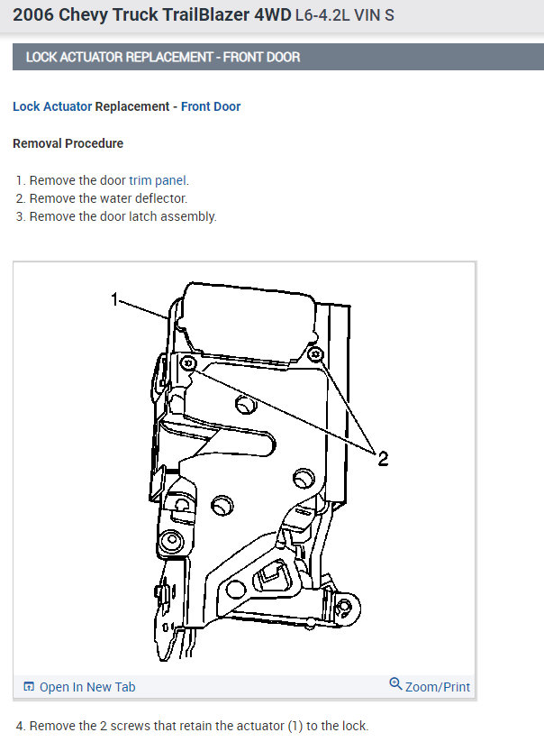

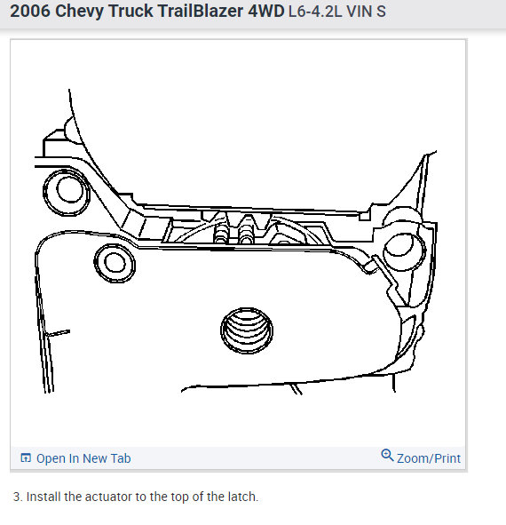

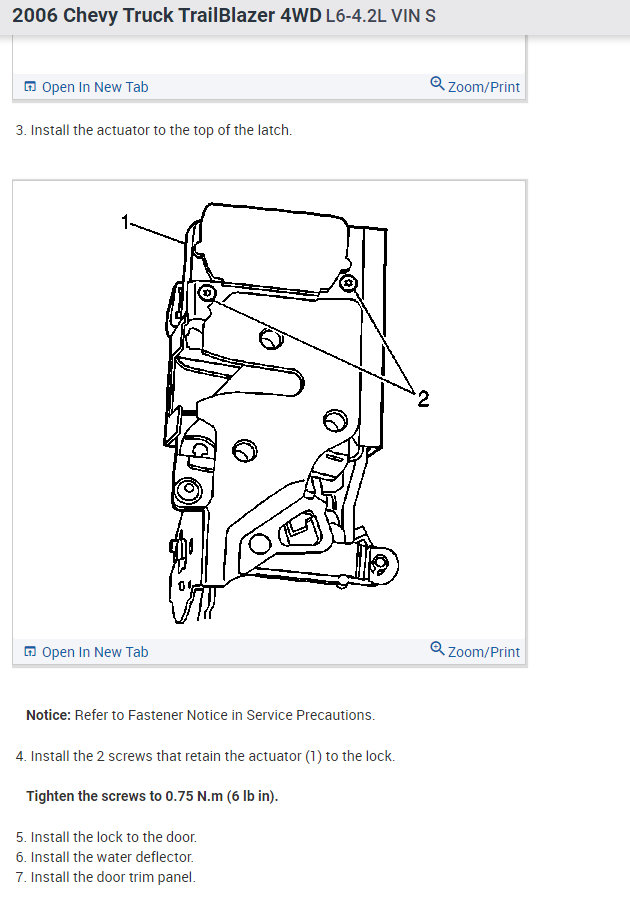

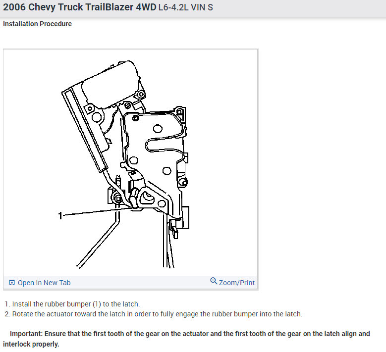

Inoperative power door lock is probably due to a bad door lock actuator for the driver side.
In order to access the actuator, you will have to remove the inner door panel.
The panel is mounted by few screws and several plastic fasteners.
Here is a helpful article:
https://www.2carpros.com/articles/door-panel-removal

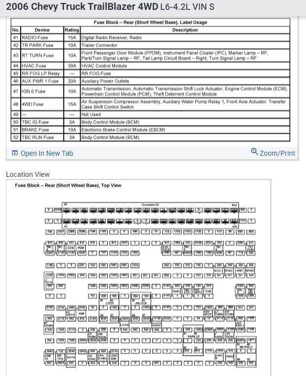

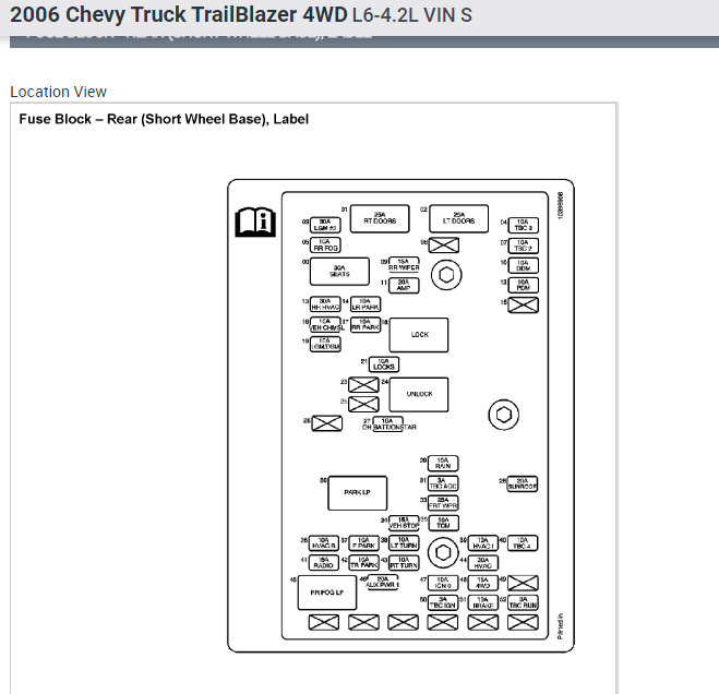

Check the fuse box in the rear for a 25A fuse that controls the driver door.
