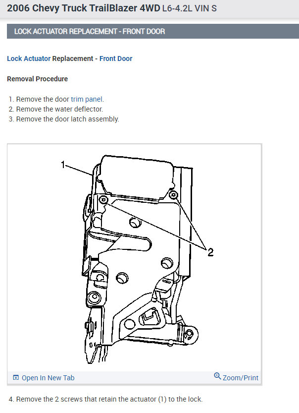

One day when it was raining I went to roll my window down and the window went down and heard the front brake grinding. Please help the repair cost alone will cost but I cannot afford a diagnostic test and repairs.
Nov 20, 2009 at 6:05 PM
SQM
  • 6,383 POSTS

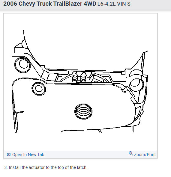

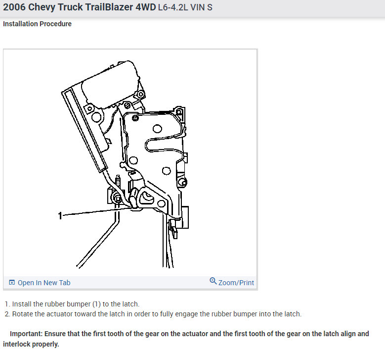

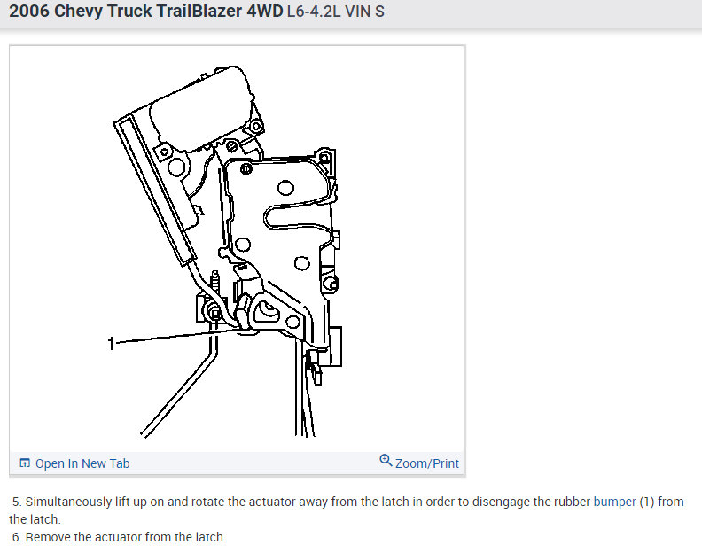

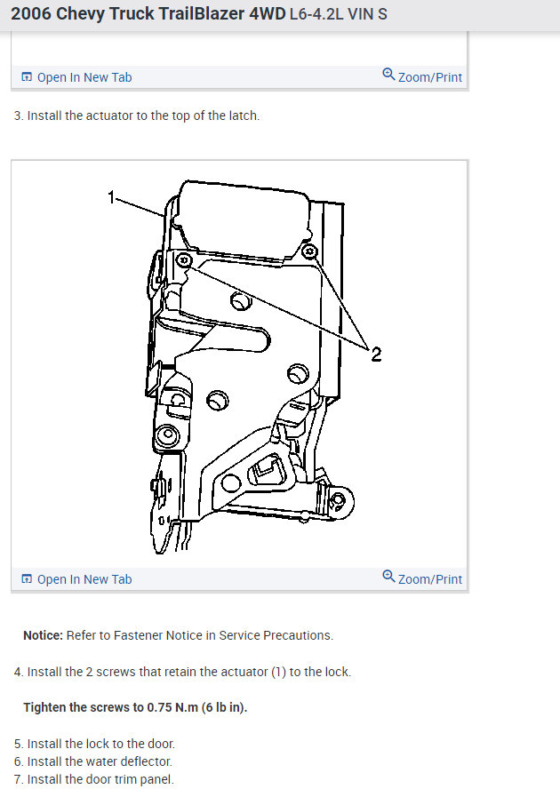

Inoperative power door lock is probably due to a bad door lock actuator for the driver side.
In order to access the actuator, you will have to remove the inner door panel.
The panel is mounted by few screws and several plastic fasteners.
Here is a helpful article:
https://www.2carpros.com/articles/door-panel-removal

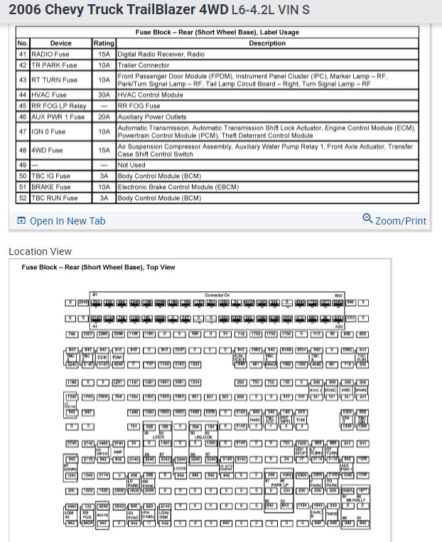

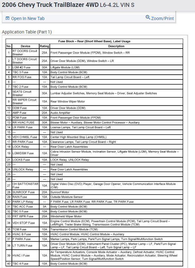

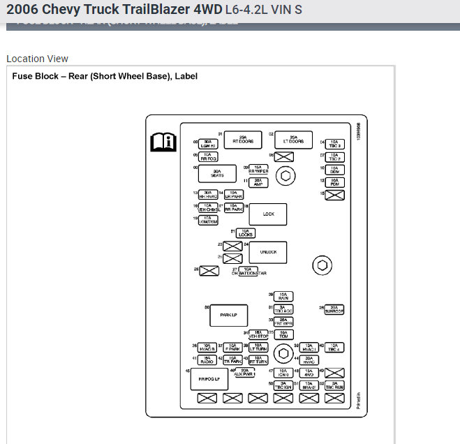

Check the fuse box in the rear for a 25A fuse that controls the driver door.
