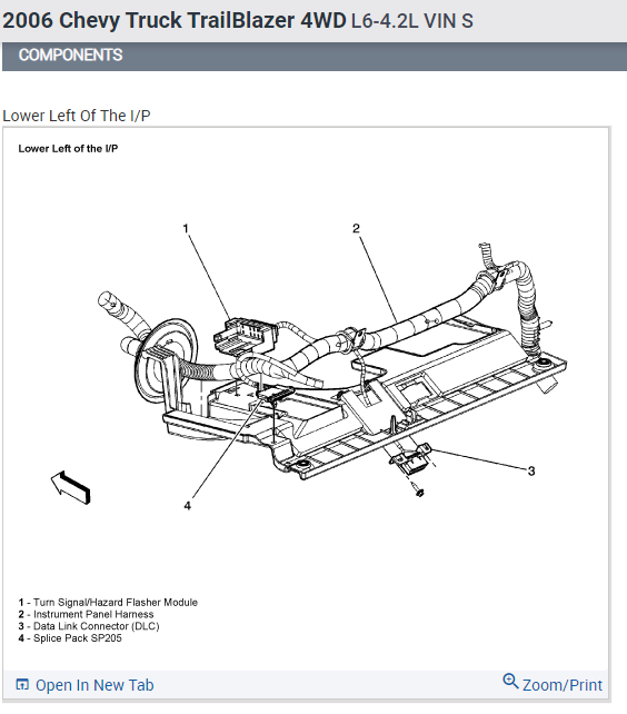

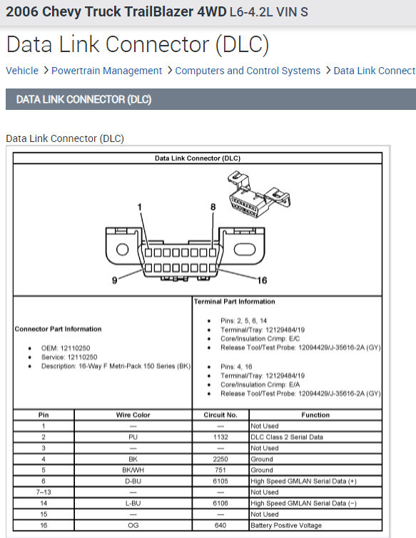

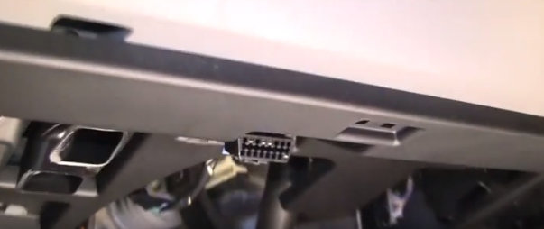

Is there a way you can give me the location for the diagnostic connector?
Aug 10, 2010 at 9:22 AM
SQM
  • 6,383 POSTS
The diagnostic port is located on the driver side under the instrument panel.
If you look under the dash just left of the steering column you will see the port.
See diagram and picture for a reference.
