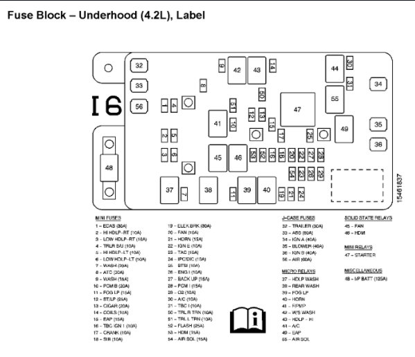

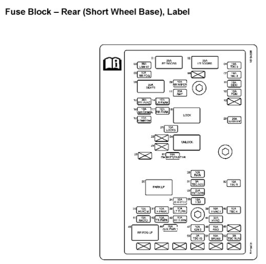

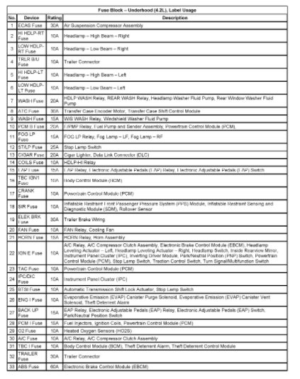

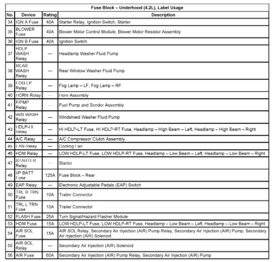

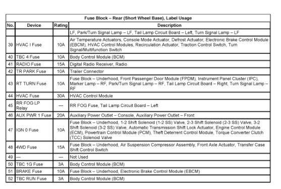

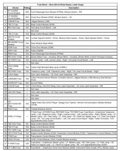

Fuse panel location the lights worked
2005 CHEVROLET TRAILBLAZER
SEABEECOP
I had the problem a week ago and after 20 minutes or so the lights worked I want to check the fuses.
Jan 23, 2010 at 8:41 PM
DANNY L
  • 5,648 POSTS
Hello, I'm Danny.
Here is the information you requested. Here are a few tutorials for you to view on how to check and replace fuses:
I've attached pictures below showing the fuse and relay locations on your vehicle. Hope this helps and thanks for using 2CarPros.
