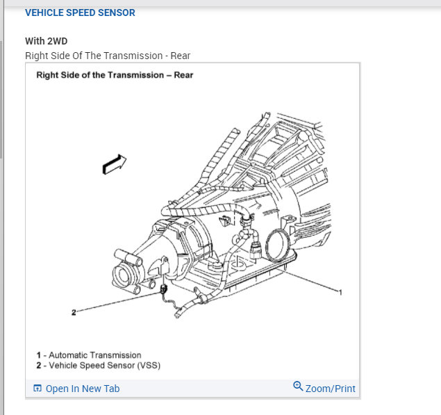

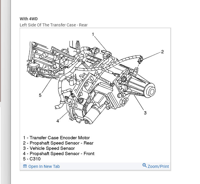

My trailblazer will not shift past 2nd gear, and my speedometer does not read accurately all the time
May 14, 2008 at 3:08 PM
More than likely this is a speed sensor issue.
So, let's start with testing a speed sensor using this guide. This guide is for a wheel speed sensor, but the process is the same.
https://www.2carpros.com/articles/abs-wheel-speed-sensor-test

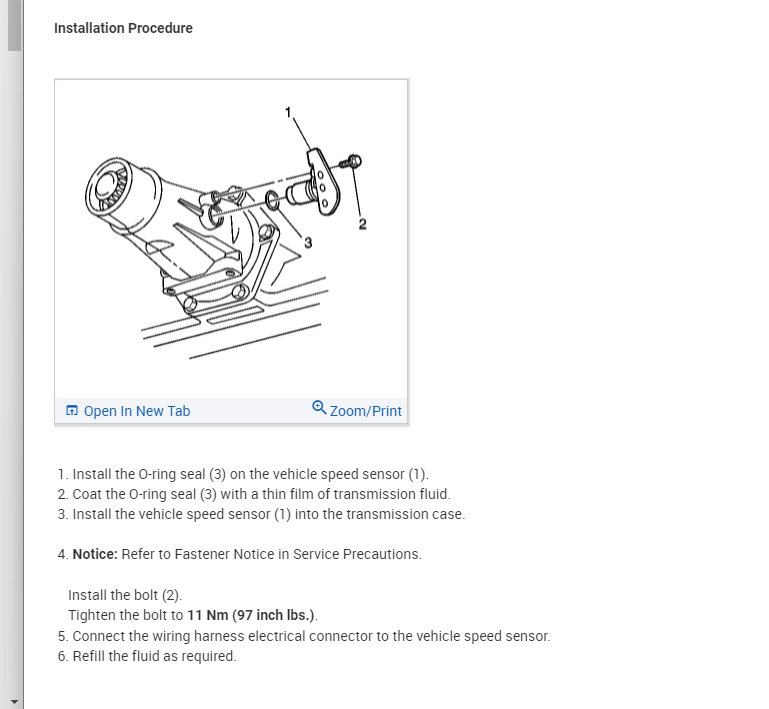

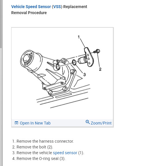

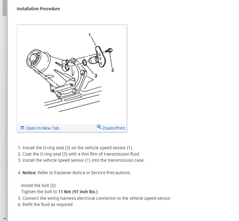

Please run through this and use the info below from the manual to do this testing and replace it if needed.
Let me know if you have questions. Thanks
