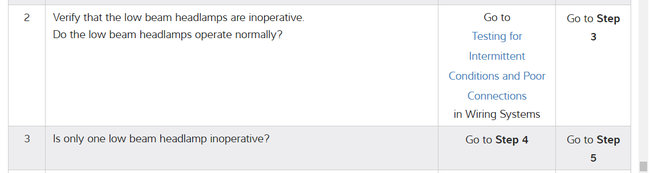

Okay, let's start from the beginning. In the diagrams down below I have included a factory diagnostic troubleshooting guide for your headlamps. Please go through this guide and get back to us with what you are able to find out.

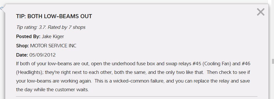

I am having the same problem right now with my 2005 Trailblazer. I got a new relay fixed it

there is a headlight relay in the under hood fuse box. Your bright lights will only work when you put them on via your high beam switch.

Welcome to the forum. Any fuses that you checked, did you use a testlite to check that the fuse circuit has voltage when it should? Also, at the relay/s, I'd have to check the voltage circuits, with a testlite. With the low beam relay, voltage to the load side of relay is hot all the time. The bcm sends voltage to the coil side of relay in order to energize. The ground for the coil is constant.

welcome to the forum, did you use a testlite on the fuse circuit, to see if circuit is hot? My info shows different fuses for left and right low beams. The fuses are in the underhood fuse box. Also, there is a headlamp driver module relay in the underhood fuse box, I believe that is for low beams. Check voltage to load side of relay and to the coil side of relay. Voltage to the coil side of relay, may not be 12 volts, use a digital multimeter to check.
