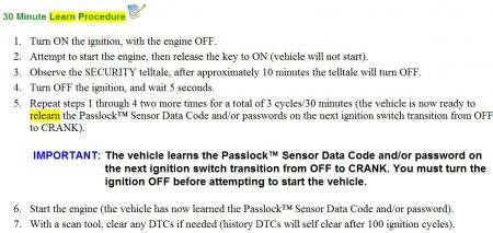

My car was sent by sea in a 20" container between 2 towns in Greenland. During transport the key was in the ignition but the car had run out of power, whwn I picked it up. But when we got power on, it would just start for a few seconds and then to stop again. Now it will not start at all, the starter run but there are no ignition, it seems like it's something about the starting lockout, we have no suitable computer available here in town, so what can I do to have my car running again Best regards Kim

Sometimes when battery voltage is lost, it may go into theft lock? Battery has a full charge and all connections are good? If you think it is the security system, you can try a relearn procedure, don't know if it will help?
https://www.2carpros.com/forum/automotive_pictures/170934_04_trailblazer_relearn_1.jpg
