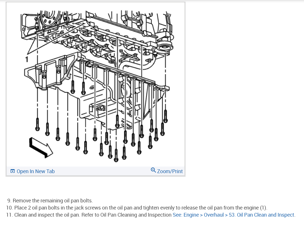

how do you remove the oil pan fron this vehicle?
Mar 5, 2008 at 7:32 AM
2CARPRO JACK
  • 11,533 POSTS

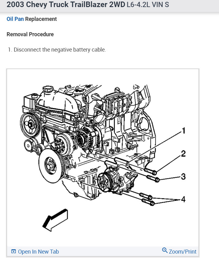

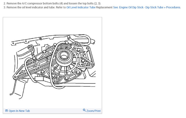

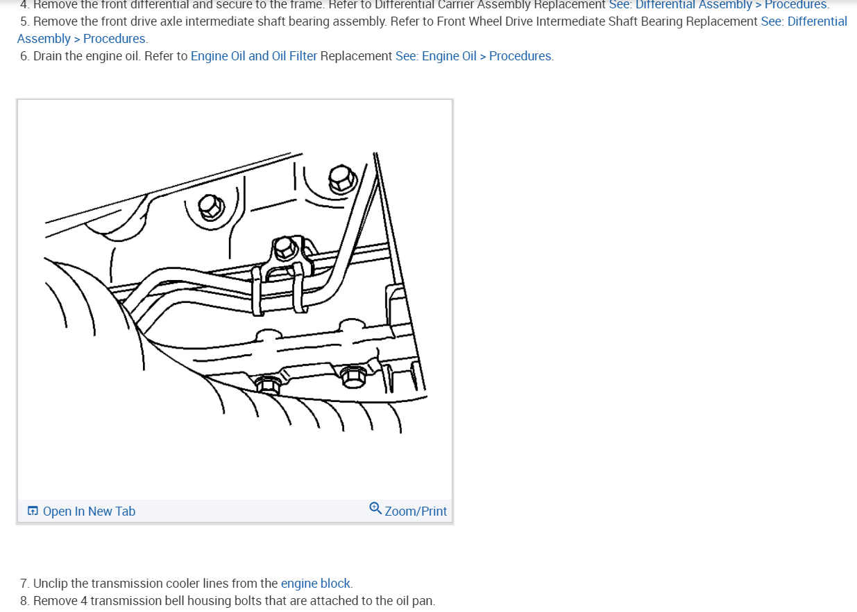

Lift and support the truck. Remove the steering gear crossmember, both axles, front diff, then the pan comes out. Here are the instructions in the diagrams below on how to do the repair. Check out the diagrams (Below). Please let us know if you need anything else to get the problem fixed.
