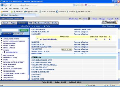

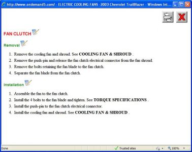

I would like to know if when the fan clutch is replaced that there is a charge for reprogramming the computer. The dealership is charging $226.99
Friday, August 6th, 2010 AT 4:54 PM
SATURNTECH9
  • 30,869 POSTS
https://www.2carpros.com/forum/automotive_pictures/416332_2003_chevy_trailblazer_fan_clutch_1.jpg
https://www.2carpros.com/forum/automotive_pictures/416332_2003_chevy_trailblazer_fan_clutch_part2_1.jpg
I don't see it listed under the instruction's of replacing them.I posted the instruction's for you to read.I also posted the labor time for it 2.8hr's time's what ever there labor rate is.
