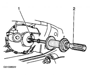

Hello, my 2003 trailblazer has a front end (left) diffretial leak it seems that a lot of people have the same problem is this something worth fixing or just keep adding fluid, because it seems that if you fix the leak it could open up a lot more problems. If you think it should be fixed how difficult and how long, I will by the book but just looking for some insite. If it is to hard then maybe I will sell it. Any one in the new york area that can fix this problem please make contact. Thanks, Greg

The leak will get worse, not better. But GM has special tool to remove and replace the seal. I would call around to reputable shops and get estimates, while the seal is not expensive, getting to it is.
https://www.2carpros.com/forum/automotive_pictures/108325_seal_1.jpg
