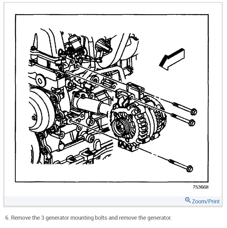

QUAD D
Six cylinder four wheel drive automatic.
Any tips on how to remove the alternator?
Jul 22, 2018 at 6:25 AM (Merged)

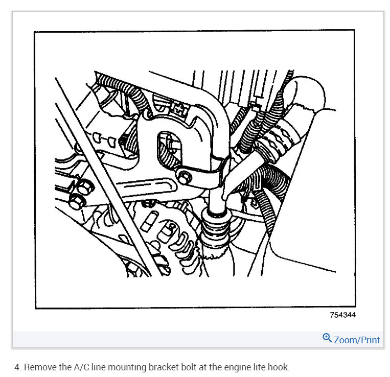

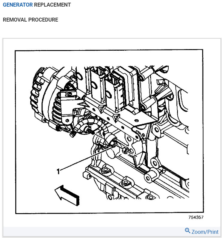

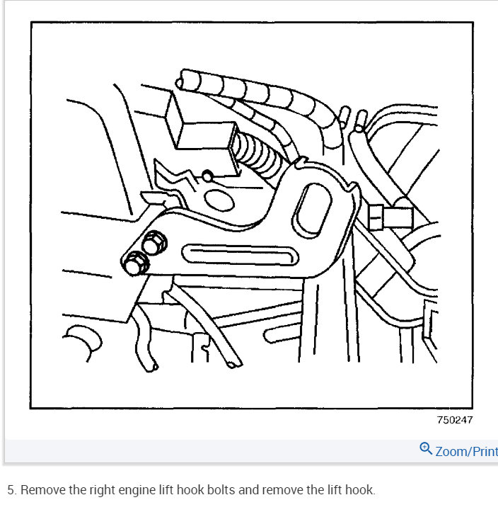

MMPRINCE4000
  • 8,548 POSTS
1. Disconnect negative battery cable.
2. Remove drivebelt.
3. Unbolt AC line mounting bracket at engine lift hook.
4. Remove the right engine lift hook and alt. mounting bolts and alternator.
5. Disconnect electrical connectors from alternator.
