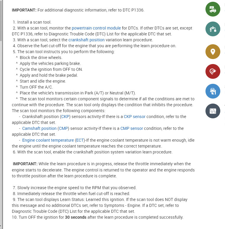

This generation of GM products do not require programming if you are installing a PCM that is already programmed.
So, you do not need the PCM programmed on this. Your issue is most likely a vacuum leak that you didn't know you had, or the throttle body needs to be learned to the new PCM.
To relearn the throttle body, I would start with checking for codes.
I am attaching the crank and throttle learn procedure below.
Please run through this and let me know if you have questions on this.
