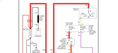

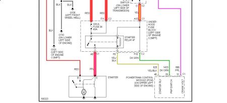

I have a 02 chevy trailblazer 4.2L it starts when it wants to. Ive replaced ignition switch still does it nuetral safety pos. On the transmission still does it. It works fine so many tries then it does nothing everything else works fine just like the ignition is dead no turning over just dead. I had to open the starter relay to start it when doesnt start for it to turn on, so went ahead and connected a switch to the relay to I didnt have to keep opening the hood. Any help PLEASE would really appreciate it.

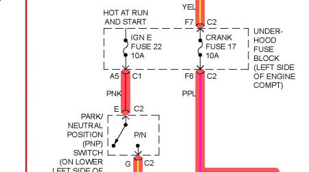

Check this fuses
https://www.2carpros.com/forum/automotive_pictures/12900_fuses_10.jpg

I had replaced the relays and fuses brand new in case they were just defected and still wasnt solving the problem its like there is just no signal getting sent

Did you test the starter relay? See EWD
https://www.2carpros.com/forum/automotive_pictures/12900_starter1_18.jpg
https://www.2carpros.com/forum/automotive_pictures/12900_starter2_5.jpg
