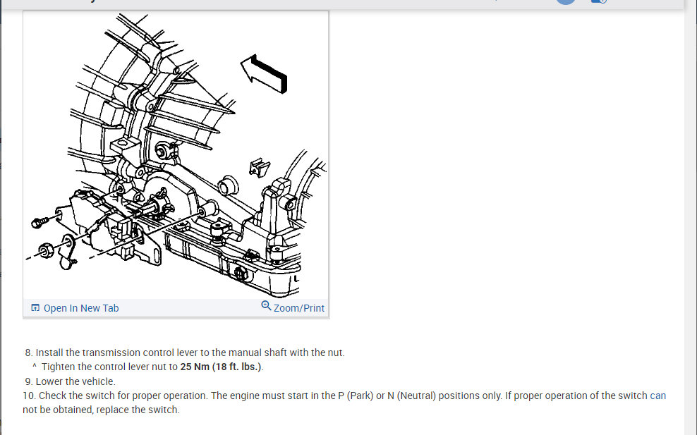

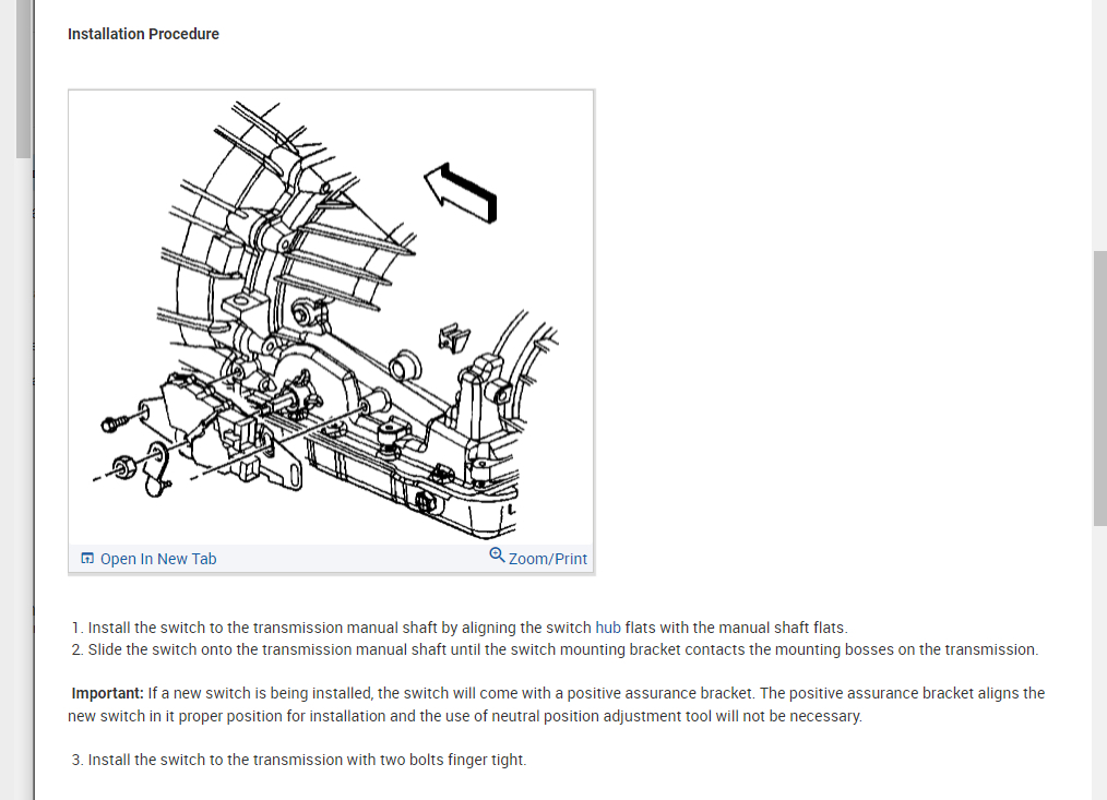

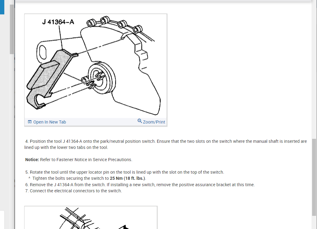

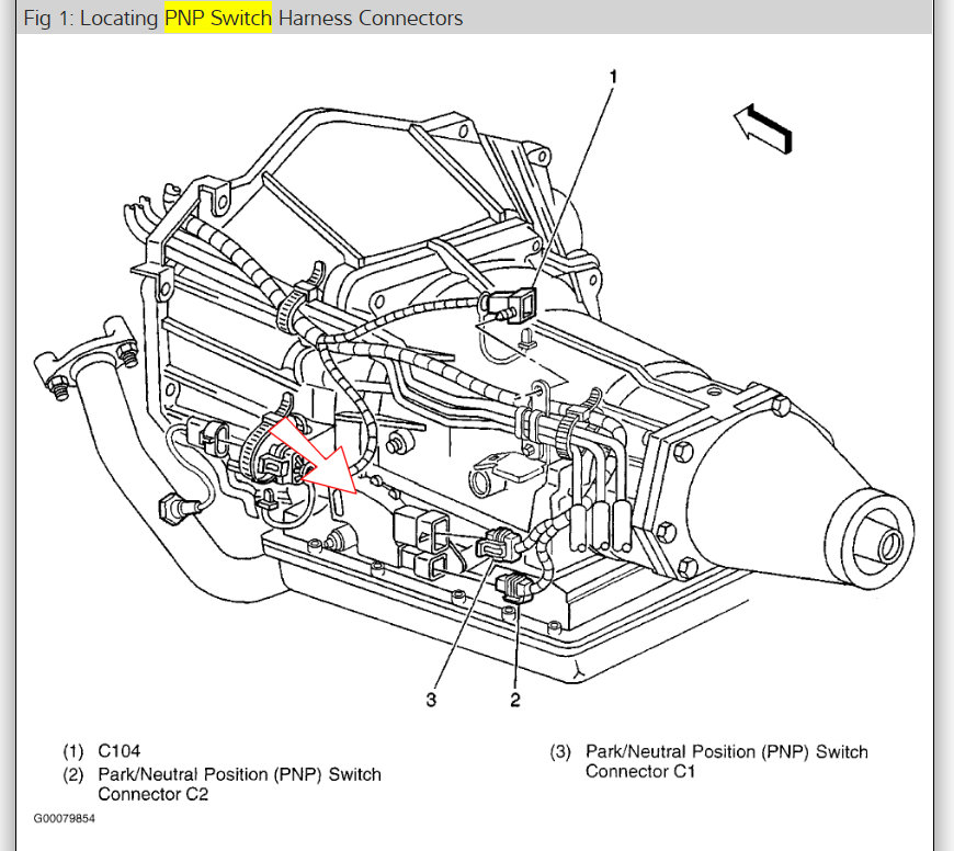

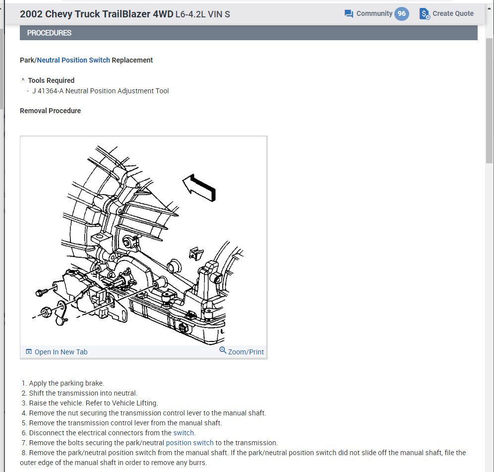

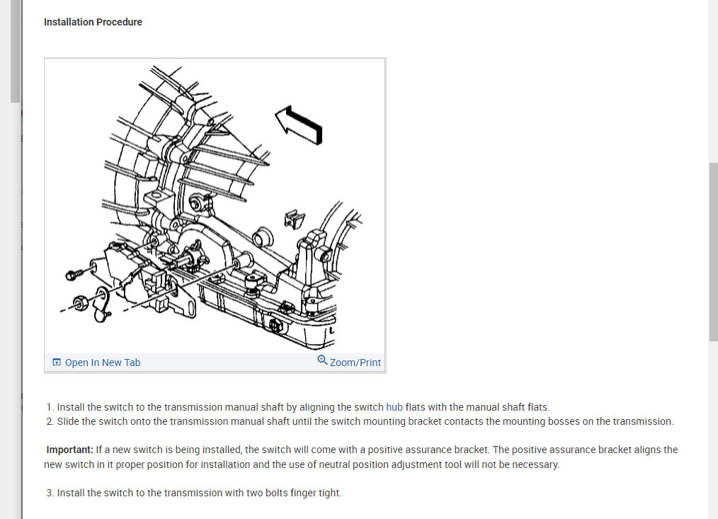

Just need to know location of switch
Tuesday, February 23rd, 2010 AT 8:39 AM
BLUELIGHTNIN6
MECHANIC
16,542 POSTS
Park / Neutral Position (PNP) switch is located on the lower left side of the transmission. Check out the diagrams (Below). Please let us know if you need anything else to get the problem fixed.
Images (Click to make bigger)
