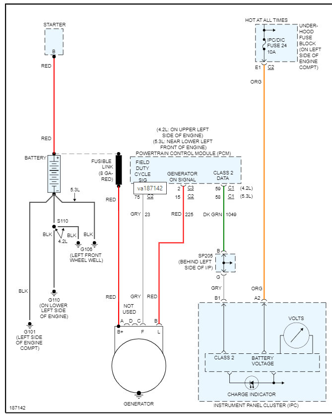

2004 LT, I had just put an entry lock rod clip on, and my battery been draining for a year, jump backed it in reverse OMG, I'm so upset.
Apr 18, 2022 at 8:11 PM
Okay. Thanks for that. So, this means we need to start with checking the power from the battery, through the fusible link to the alternator and starter.
If we have no voltage here or not 12 volts, then we may have a battery issue. So, at that point, check the batter to find out if this is shorted.
If not, then we need to start moving through the system to find where the issue is.
Basically, the common things that these effects are circuit boards so that means we need to check fuse panels for power and then each module.
Also, we can check for codes and that will help us figure out what may not be operating.
Thanks
Apr 19, 2022 at 3:10 PM
TOMMY GUNZZ
  • 6 POSTS
Brand new battery was the fix, $175.00.
