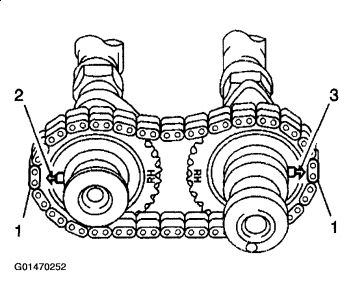

I need the timing marks for the secondary timing chain

https://images.2carpros.com/forum/automotive_pictures/261618_Graphic_241.jpg
