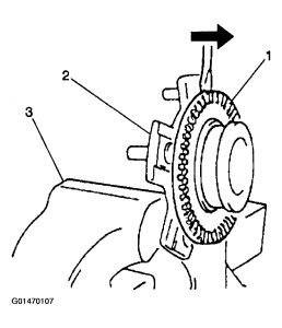

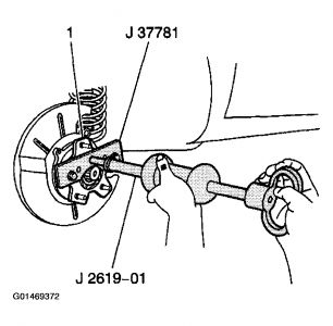

I need to change some wheel studs on my front hubs but the ABS reluctor ring is in the way. How do I remove and reinstall it - Thanks

Must remove hub see diagram
https://images.2carpros.com/forum/automotive_pictures/198357_Grafic_3_165.jpg
Then pry off ring
https://images.2carpros.com/forum/automotive_pictures/198357_Graphic_694.jpg
Then remove studs
