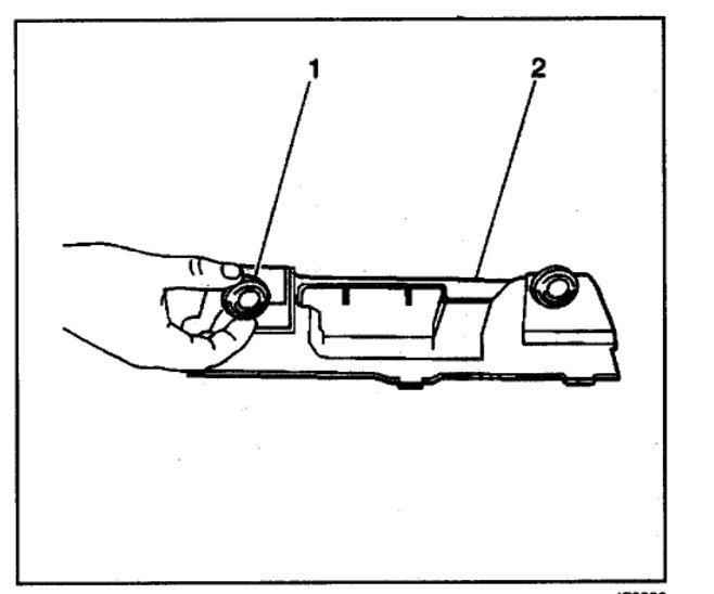

how do i change the bulb on the license plate on my 2202 tracker

You must remove the license plate first. Then remove the mounting nuts to remove the bulb housing.
Here is a diagram to help you with the job.
